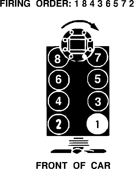

Bad wires can cause the car to run badly. They could be cross firing, where the spark jumps from one wire to another because the insulation is old and weak. It could also be that you switched wires by mistake. Attached is the firing order for your engine. Please double check that you have the wire correctly connected. If that is not the problem, then I would suggest changing the wires, as they likely need to be done.

That is the order they are in. I will try changing them and see how that goes.

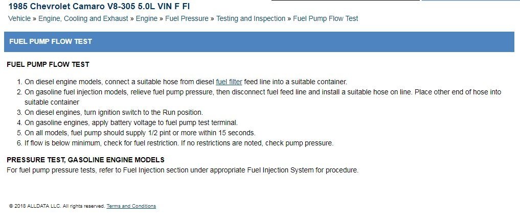

Ah well it's not that then. Next thing I can think to check would be the fuel filter and pump. If you haven't replaced the filter in a while, go ahead and do it. As far as checking the pump, we have a how-to guide for that. https://www.2carpros.com/articles/how-to-check-fuel-system-pressure-and-regulator
You can borrow a fuel pressure tester from AutoZone for free (just pay a deposit, it gets refunded when you return it). I'm also attaching ALLData's guide on checking fuel pressure. If you decide to go with the pressure tester method, you should get 5.5 to 6.5 PSI.
+1
