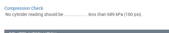

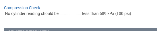

More than likely you have a valve issue. I would run a compression check to start and then a cylinder leakage to see where you are loosing the compression assuming it is low. However, this sound like a broken valve spring.
Let me know what the compression readings are and we can go from there. Thanks
