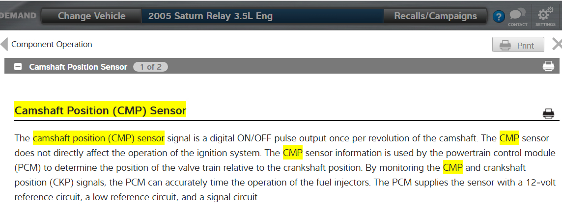

I have a 2005 3.5L out of Saturn relay I bought engine to replace my worn out 3.4 in my 2000 Impala. I changed the plenum and fuel rail and injectors and all the sensors to use the Impala 3.4 engine wiring harness and now it backfires. do I use the 3.5 crank sensor on the back of the motor or can I use the 3.4 crank sensors? How do I wire the 3.5 crank shaft sensor to the 3.4 engine harness for engine to run?

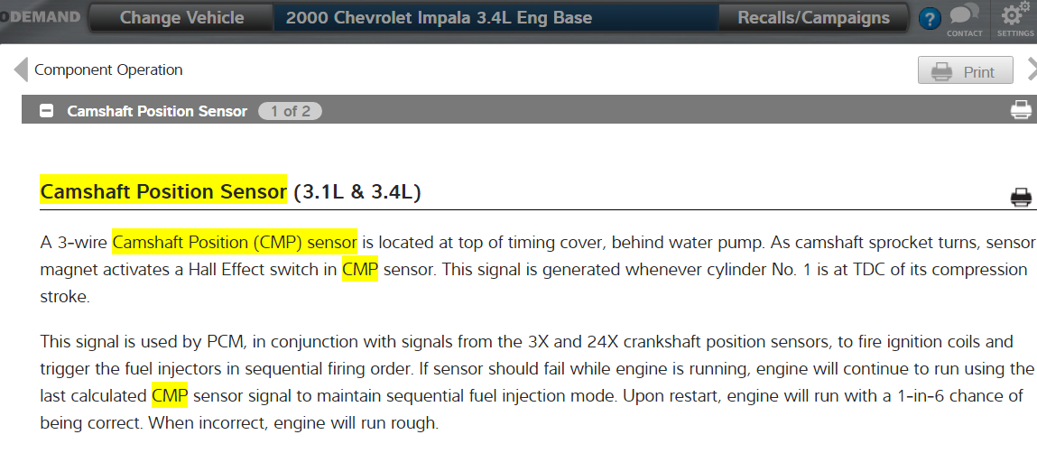

It looks like the two different engines use two different types of strategies for their Camshaft Position Sensors (CMP)(s). The answer here is to run the original 3.4L CMPs to make not only the wiring harness, but more importantly the Power-train Control Module (PCM) which is going to use the information any ways, to work effectively in providing Electronic Fuel Injection (EFI) control. I have included the descriptions of the two different CMP operating systems in the diagrams down below for comparison.
Get back to us with how it turns out or if you have additional questions, please, don't hesitate to ask. That's what we are here for.

Well I did use the original 3.4 cam sensor because it was new. I think it was like $35.00 I paid for it the cam sensor in 3.5 was made different it came to an almost point like shape. when I change them around I thought this shouldn't be an issue and put new 3.4 cam sensor in its place. the crankshaft sensors are completely different though my 3.4 has two crankshaft sensors one under harmonic balancer and one back of the engine. this is where my problem is this crank shaft sensor has two wires to run to ignition module the 3.5 crank shaft sensor has three wires and also it is maybe a half inch shorter than the 3.4 crank shaft sensor. the three wire sensor ran to the engine wiring harness somewhere in the Saturn relay. the coil packs are made completely different from each other.

You can also tear out the 3.4L wiring harness and PCM and replace it with 3.5L wiring harness and PCM, This is really going to be your only solution short of fabricating your own CMP's.
