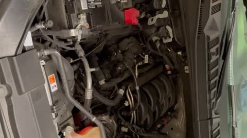

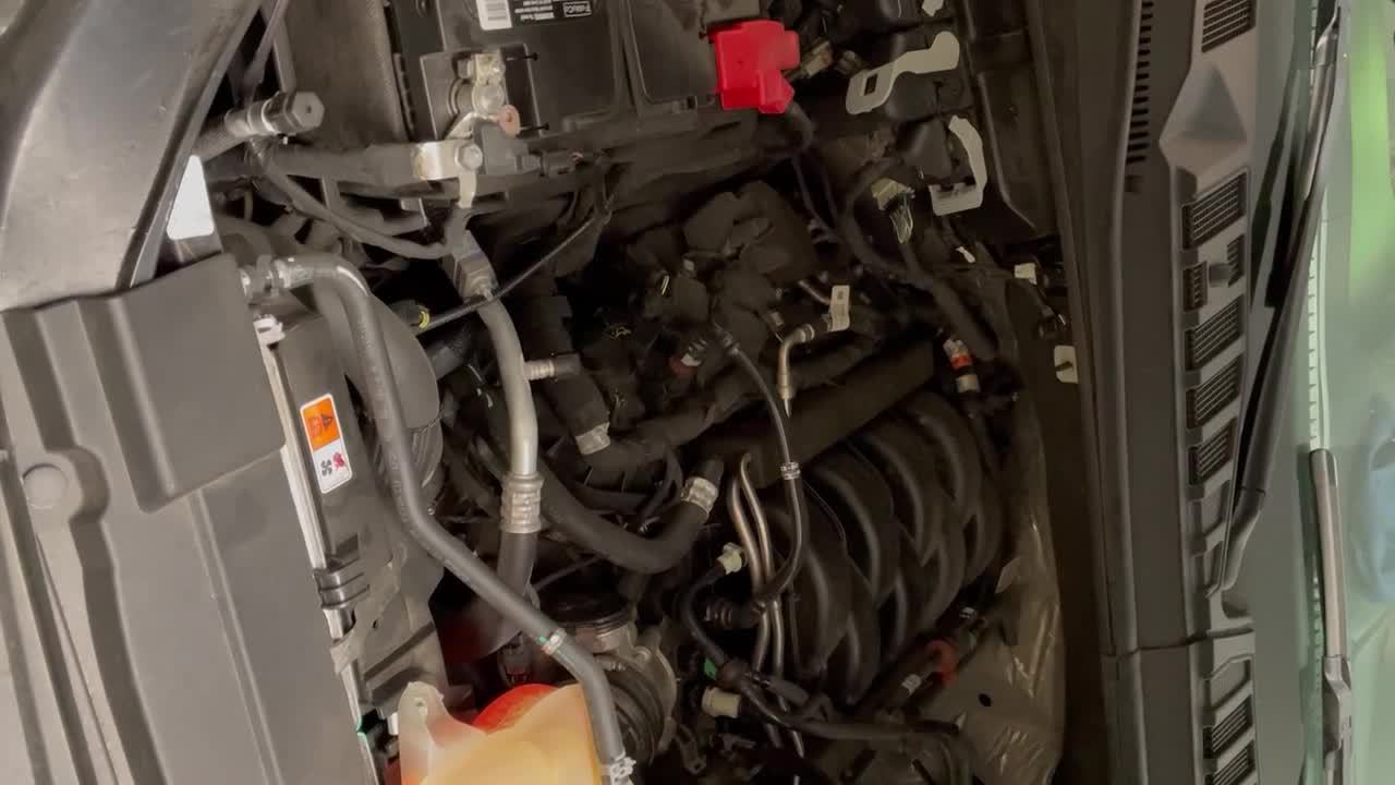

After having the fuel system serviced at a lube shop, there is a backfire noise under the hood when starting. Causes?

Also, if it is loud enough to record and upload for me to hear, that may help me. Keep in mind, I'm not sure what procedure was used to service it. However, many of these shops feed a cleaner through a vacuum hose. So, you may want to check for any hoses that were left disconnected. Here is a link you may find helpful:

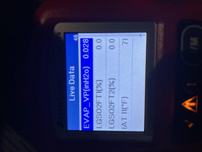

Yes, it only does it one time on a cold start. It also seems to occur after it has sat like 2 or more days. As far as I can tell the short-term fuel trims are 0.

In a perfect world, you want the trims to be 0, but that rarely happens. When it is running, are they changing between negative and positive numbers?

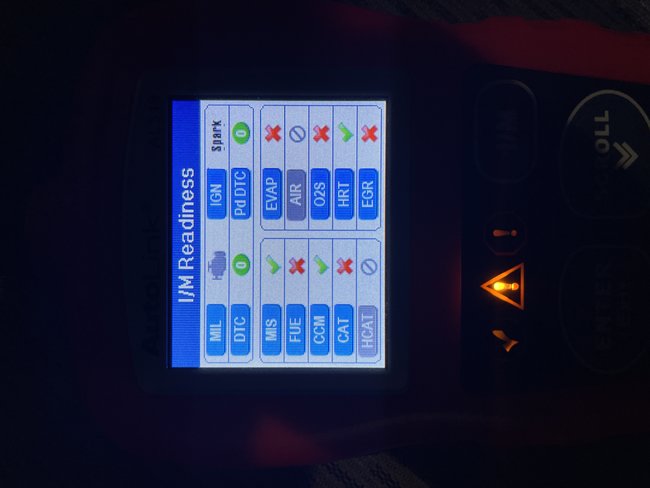

Also, is pic 1 indicating the oxygen sensors' voltages?

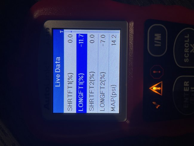

After starting the short- term fuel trims were +10-13 and as it ran they went down to +1-3. The readings never got into negative readings.

When first started, the engine runs in a closed loop. Basically, it runs at a preset from the manufacturer. Once temperature is reached, then it goes into an open loop. At that point, the computer determines fuel trims based on readings from the oxygen sensors.
Normal conditions for trims are between -10% and +10%. The negative number indicates the computer is trying to lean the mixture and the + indicates the opposite. Being between 1 and 3 is actually good, but on most vehicles, it will go into the negatives and then back.
Since you never see negatives, the comp is trying to add fuel. Are you certain there are no vacuum leaks? Is there an exhaust leak before the catalytic converter?
I have a feeling something was left disconnected causing a vacuum leak.
