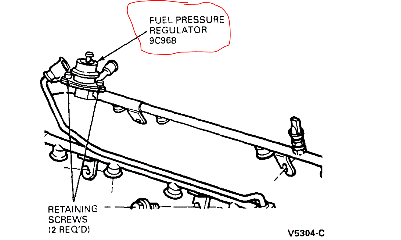

My engine backfires under a load, even more so at about half throttle. It somewhat goes away at full throttle, but sometimes it won't even rev up to get there. It's been suggested by a mechanic that it's is a valve guide problem. But if I unplug the MAF the backfire goes away, however the engine definitely is sluggish/less power.
I have replaced the, fuel pump & filter, spark plugs & wires, distributor (2 times) & cap & rotor, MAF (2 times), oxygen sensor, fuel injectors and the computer.
It is a OBDI so it's hard to get much information from the computer.

The MAF sensor measures the total volume and mass of air flowing into the engine. It is one of the major factors used by the Power-train Control Module (PCM) in determining the fuel injection base pulse width and ignition timing advance. When you disconnect it, the system goes into a predetermined setting which is likely causing less fuel to enter the engine.
This may sound crazy, but have you checked the fuel pressure to make sure it isn't excessive? Pull the vacuum hose of the regulator and see if it is dry or if there is evidence of gas in it. Also, let me know if you have checked pressure.
Aug 10, 2020 at 3:10 PM
SLYNN
I have checked and replaced the pressure regulator. I didn’t check the pressure but the mechanic did and said it was fine.
