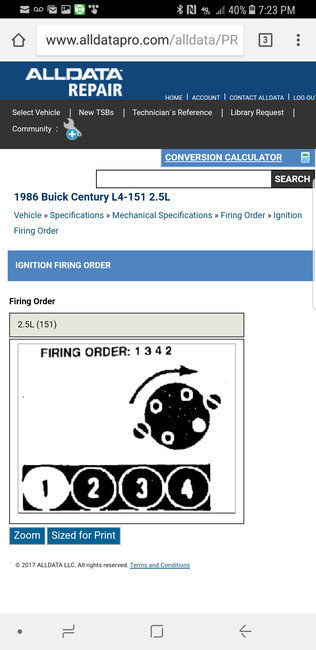

Okay, first i had no fire to spark plugs so i changed the coil pack distributor cap, the rotor and the ICM. now when i try to start it and press the gas it backfires in carburetor and starts a fire. what can it be?

I parked it on a Monday night and then on Tuesday morning it would not start all it did was crank but not start. so i check for fuel to carburetor and i could see it spray into carburetor but not start. so i checked for fire in which there was no fire coming to plugs so i changed coil pack and still no spark. then i removed distributor cap and found rotor was melted on the side so i changed cap and rotor. That is when i tried starting it again and car started sputtering and when i press gas pedal fire shoots up from carburetor. I thought my friend had put the new ICM in, but i found the new ICM in my toolbox. Do you think the old ICM could cause this problem?

No, you would just have a spark issue a lack of or intermittent spark if it ran fine before. I highly suspect something is up with the spark plug wire routing. Sounds like the cap and the rotor was the original issue with the spark issues. i know you said you checked the routing and you said it was fine, but I have been told that before and it ended up being what I suggested that was already checked.

Okay, do you have correct firing order?
Oct 23, 2017 at 12:20 PM
SATURNTECH9
  • 30,868 POSTS
I posted the firing order and spark plug routing on the distributor cap.
Oct 23, 2017 at 12:25 PM
CRAZY CRACKER
  • 10 POSTS
So number one wire goes to the cap point front closest to drivers side and number three goes front side closest to passenger side.
Oct 23, 2017 at 12:33 PM
SATURNTECH9
  • 30,868 POSTS
Yeah one, three, four, two, is that what you have?

Good afternoon, i checked the plug wires and yes they are correct. i am going to get new plugs and wires later this evening.

Changed plugs and wires still doing the same
Oct 26, 2017 at 1:05 PM
  • 55,770 POSTS
It sound like you may have a camshaft or valve issue. Can you do a compression test to see whats going on? Here is a guide to help you
