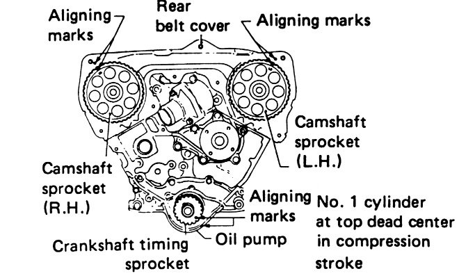

When I hear backfire I think spark timing and valve timing. How long since a tune-up? Here is link for backfiring:
https://www.2carpros.com/articles/engine-backfires-while-running.
Repair guides at top of page, check it out a lot of good information, different links. Spark timing, 15 degree btdc. As far as valve timing have to check timing belt. In the diagram you can see the alignment points for cam and crank. If you get a new belt, make sure the new belt has the proper shape teeth, evidently some belts have different shaped teeth and it makes a difference or there wouldn't be a service bulletin about it.

Timing belt was replaced ten thousand miles ago so still pretty new and done at a shop. checked the spark plugs all are firing and in good condition. still i played with the distributor to see if advancing or retarding it would fix the pop it didn't. I do not know if it is my MAS or a fuel pressure issue or a air fuel mixture problem.
