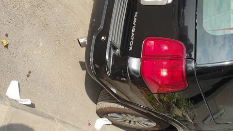

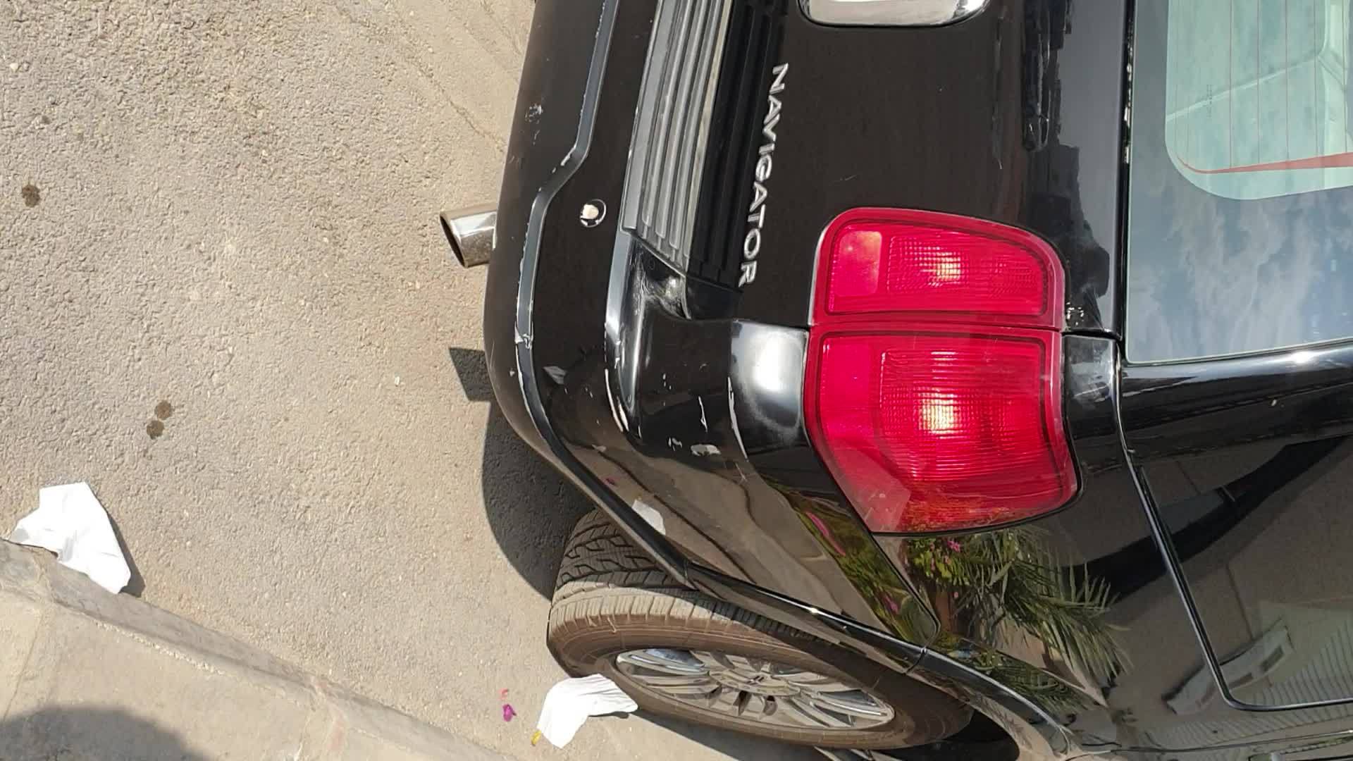

I was driving the car when it start to lose power tried to park in the road side, the low pressure oil light came out then the car was off by itself. Checked the engine no oil. No leaks when I refill the engine with oil. Try to start the car but it would not start, it cranks but sound of backfire come from exhaust. Cleaned the sparks. No benefit.

Thank you for your kind respond, I already did most of what is in you link. Attached video for your kind reference.
