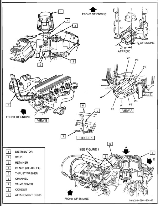

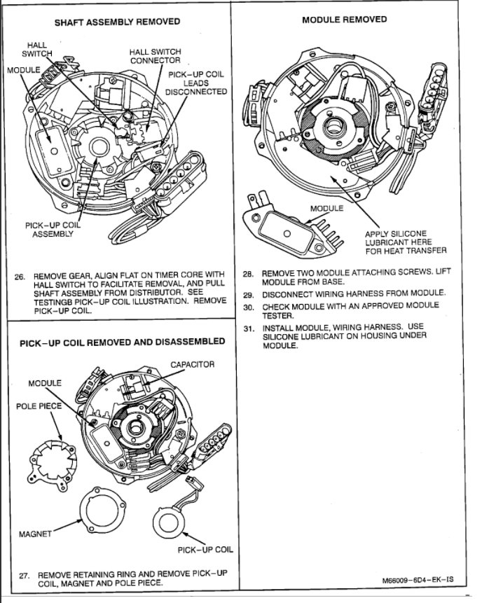

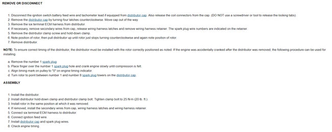

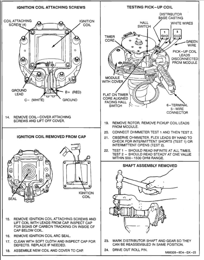

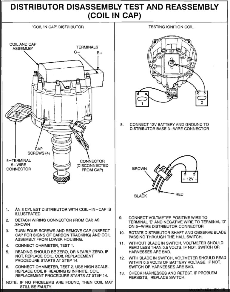

I would replace the ignition coil module and pickup coil in the distributor. Here is guide to show you how to do the job.
This is most likely the problem check out the diagrams (Below)
