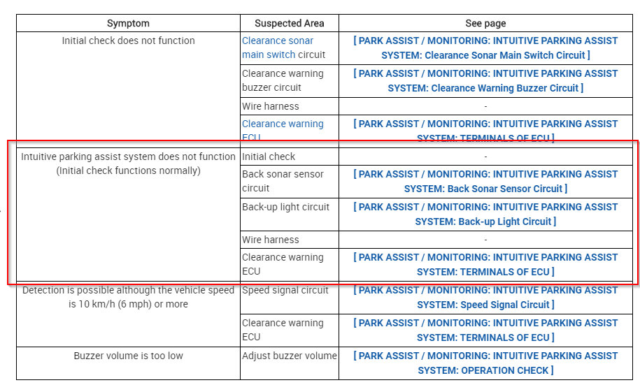

This is an fj crusier, when i put it in reverse, inside the car beeper lets me know that it's in reverse, but as i am backing up, and getting closer to anything, i don't hear anything. This problem just happen the past few days and was working. I did check the connections i the rear and they are plug in, the fuse is good. Could it be "both" are bad , or if one doesn't work, then both don't?? They seem very hard to replace ,which are under the rear bumper and looking at you tube videos, it looks like a pain. Any help on this issue? Thanks
Oct 5, 2020 at 10:22 PM

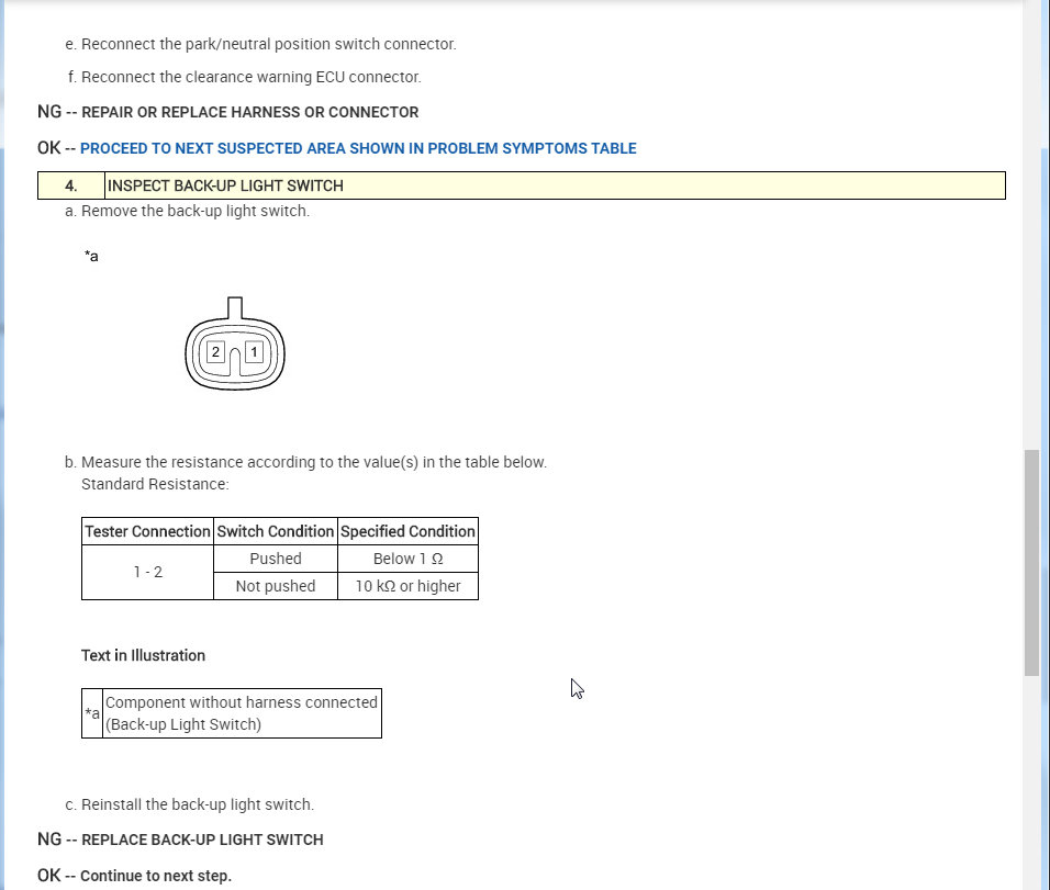

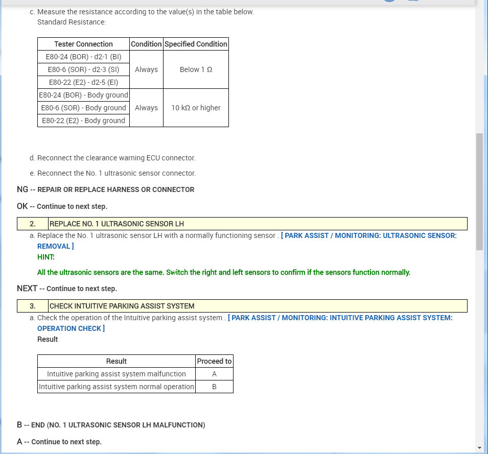

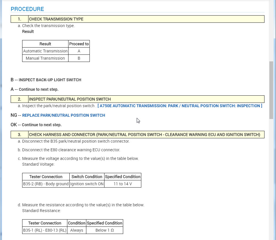

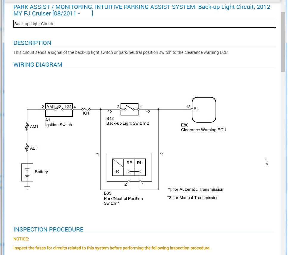

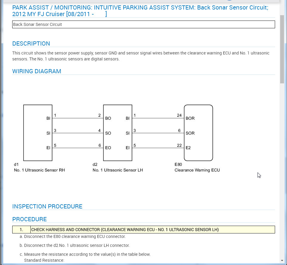

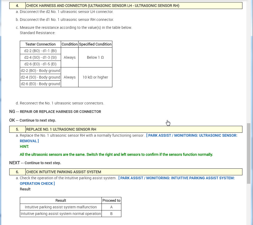

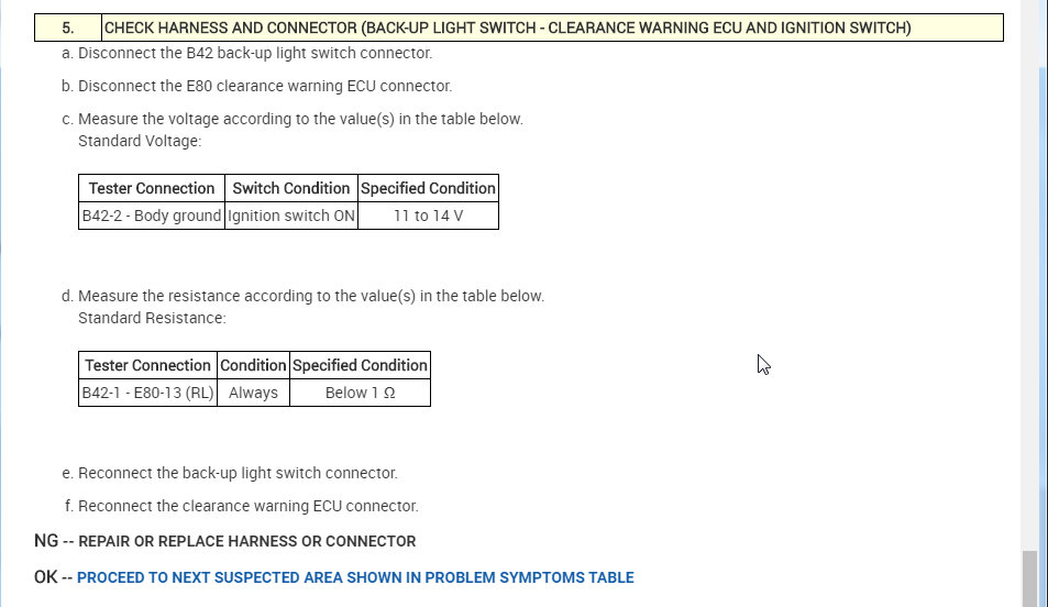

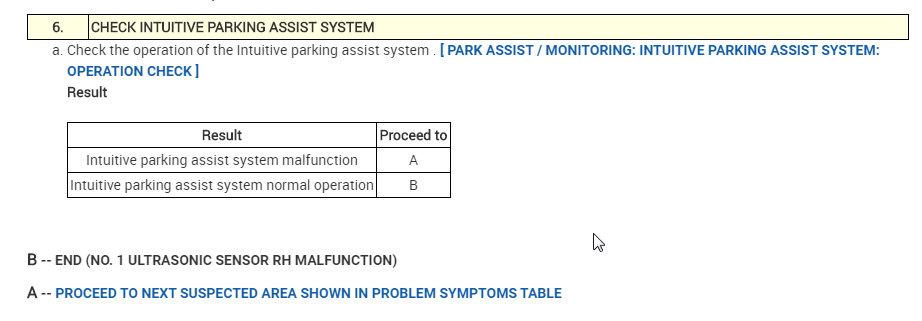

In general the sensors are independent so if one fails the other should still operate. However, we need to run through the testing that I attached to determine what the possible cases are. Let's run through this testing and see what we turn up. Let me know what questions we have. Thanks
