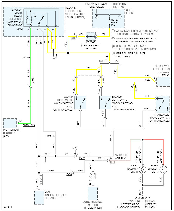

I want to install a backup camera and I want a wire diagram for backup lights.

Sure, it sounds fun, here is the reverse light wiring diagram so you can complete the job. Check out the images (below). Please let us know what happens.
