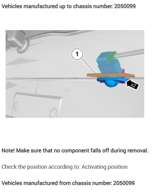

When placed in reverse i get a full blue screen with a symbol of the camera in the middle of it with an x on top of the camera.
Sep 21, 2024 at 6:41 AM
  • 55,399 POSTS

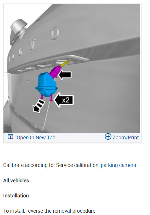

Yep, this means the camera has stopped working. here is how to install a new camera. Check out the images (below). Let us know if you need anything else.
