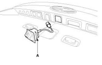

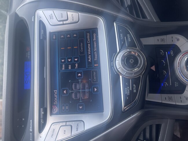

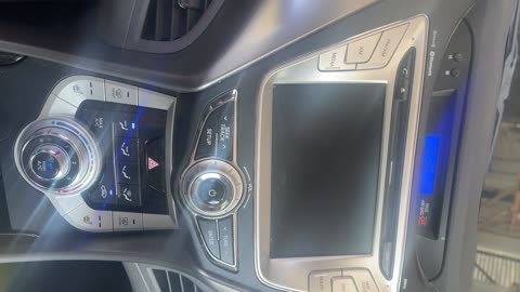

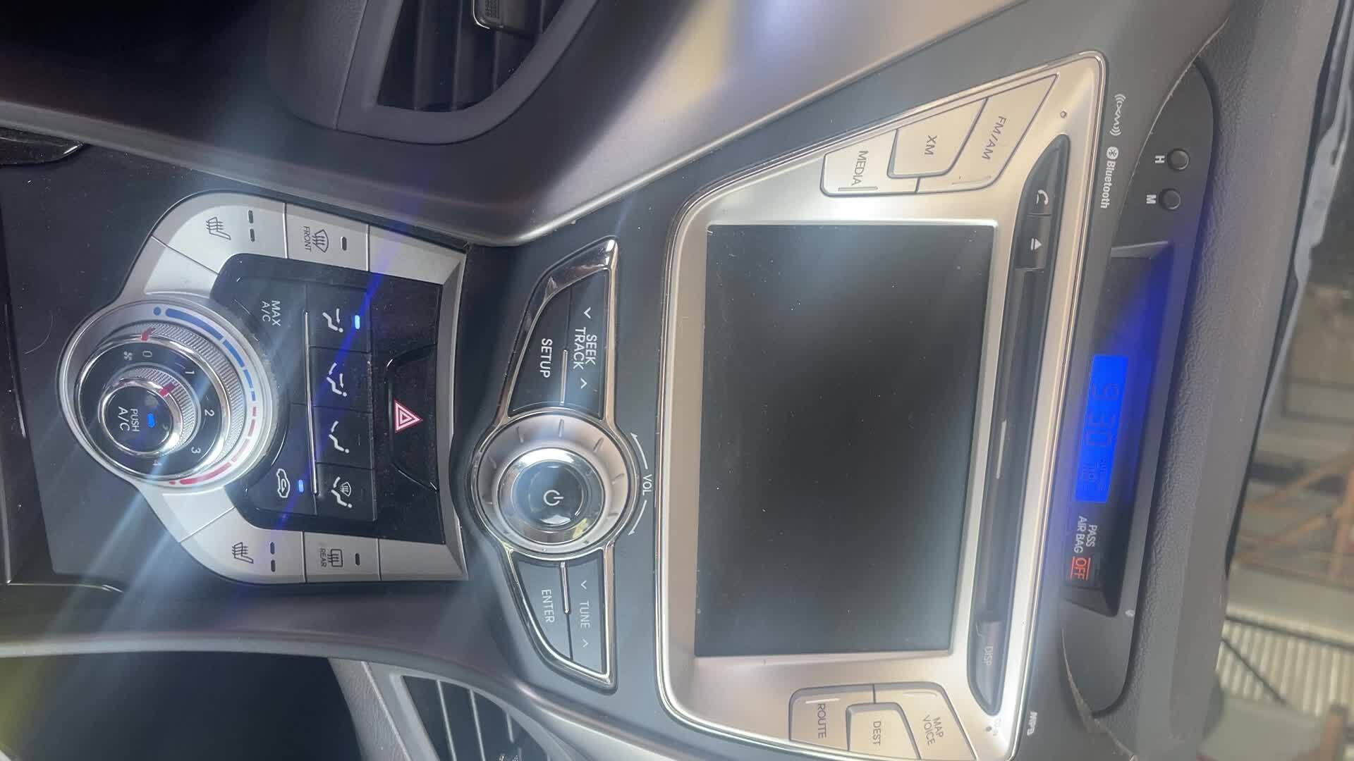

Do you think this is a camera issue or a head unit issue? camera starts fine then starts to do this or go back. Nav screen is fine, radio and all other screens showing good
Sep 5, 2025 at 1:49 AM
  • 55,710 POSTS

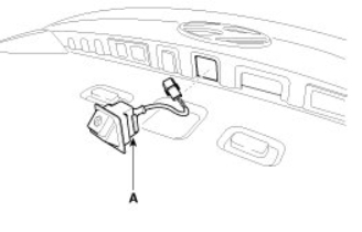

This happens when the back up camera goes out. Here is the location so you can change it out. Check out the images (below). Let us know how it goes

solved, it was the camera. thanks
