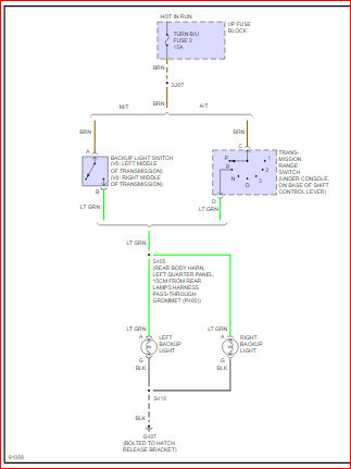

Back-up camera install, wiring diagram needed

Hello, I have the car listed above with manual five speed transmission. I bought a reverse back up camera for my car and I have to wire it to my reverse lights in order for it to work. I wanted to know if anyone has the reverse light wiring diagram for either driver or passenger reverse lights so that I know what color wires to hook the camera up to. so I would know which light wires to look for and quick is positive and which is negative.

Here is the diagram you asked for. I attached the picture. Hope this helps and feel free to ask any further questions! Thanks for using 2CarPros. Danny-
