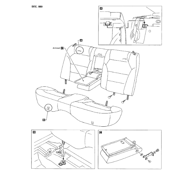

How to remove the back seat?
2000 INFINITI Q45
99,000 MILES • V8 • 2WD • AUTOMATIC
LOU COLETTA
how to remove?
Mar 29, 2023 at 11:33 AM
LOU COLETTA
remove the back seat.
Mar 29, 2023 at 11:35 AM
  • 110,194 POSTS
I attached a picture below showing the mounting locations. That is what is provided in my manual.
Looking at the pic, it appears you first release the lower section from the front two retainers, then lift it upward to remove it. Once that is out, the back section is bolted in place.
Let me know if this helps or what I can do to help.
See pic below.
