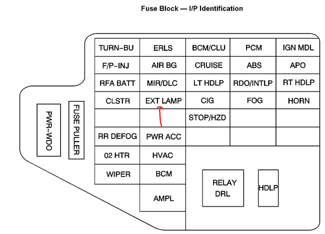

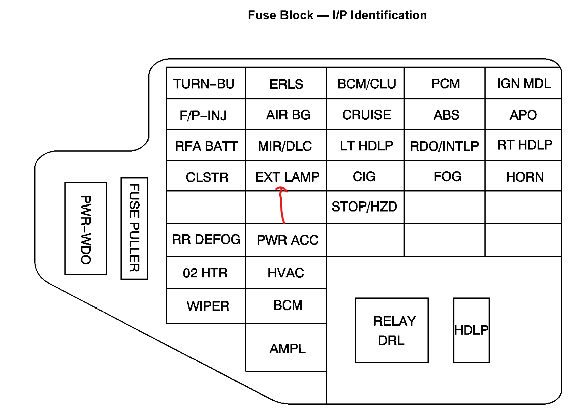

The first thing we need to do is check the EXT LP fuse 20 amp in the fuse panel inside the car, this guide can help you and I have included the fuse location in the images below.
Check out the images (below). Please upload pictures or videos in your response of any problems so we can see what to help you with.

Still have not found the problem to my running back lights and dashboard lights not working blinkers work brake light work front head lamps work but just no back lights or dashboard lights cheeked fuses but can't really pinpoint the exact location on the diagram of fuses for backlights or dashboard. please help.
Aug 25, 2024 at 3:18 AM (Merged)
  • 55,433 POSTS
Did you check the fuse I listed above?
Aug 25, 2024 at 3:19 AM
BABYMARY
  • 5 POSTS
Yes.

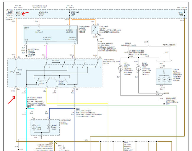

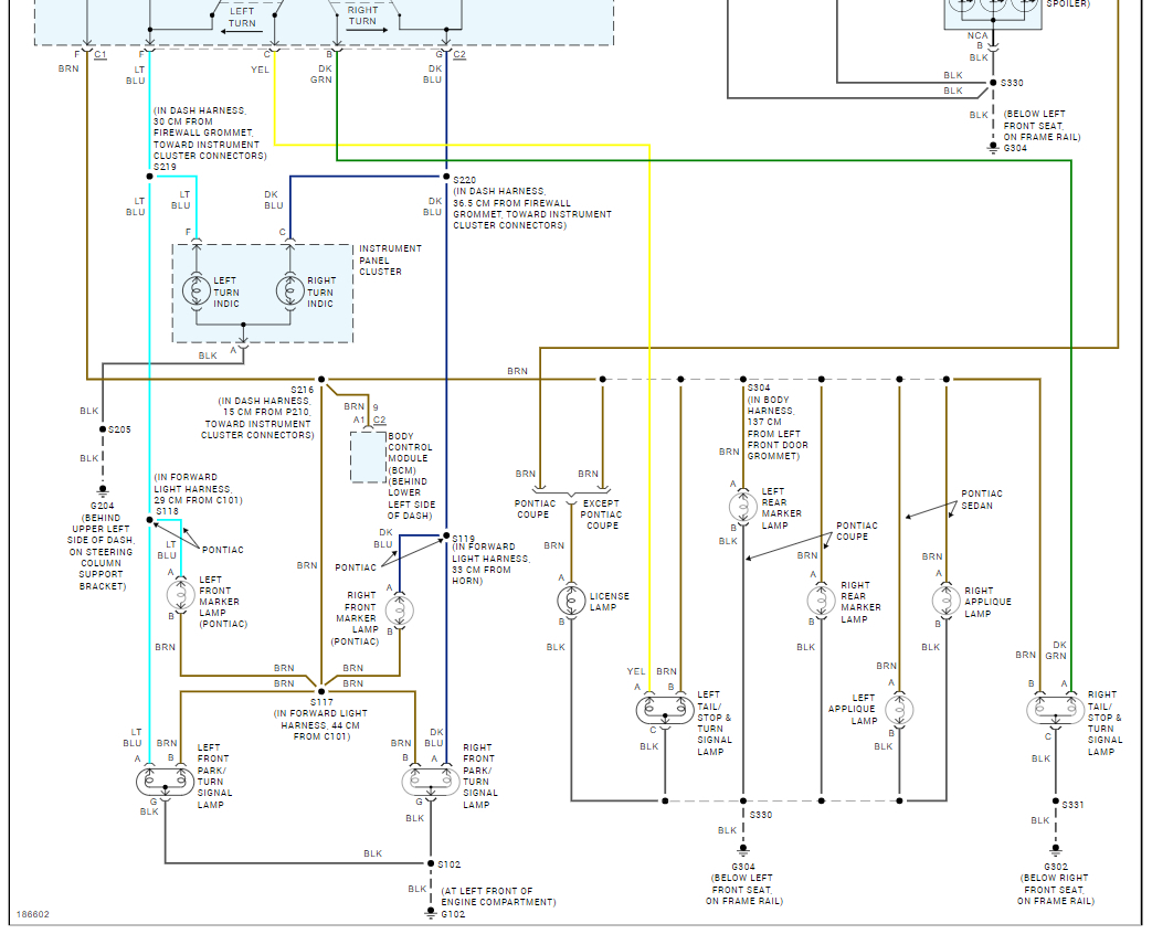

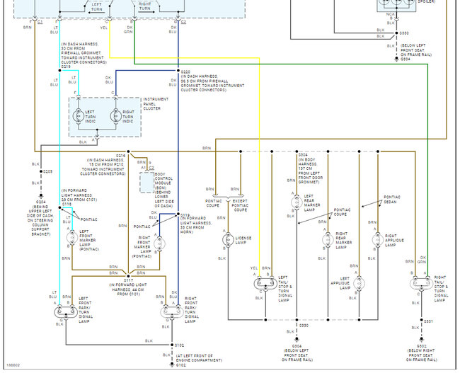

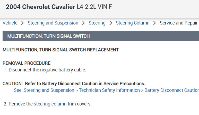

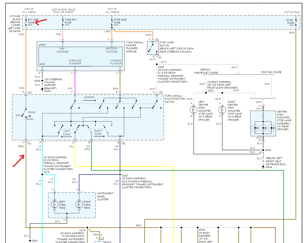

Okay, if you checked the fuse for power and the fuse is okay turn the headlights on and check the brown wire at any running light socket, if there is none then chances are the multi-function switch is bad.
Here is a guide to help with the running light wiring diagrams so you can see how the system works:

Thank you so much. problem solved once you pointed out the correct fuse. thank you so much.
