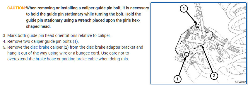

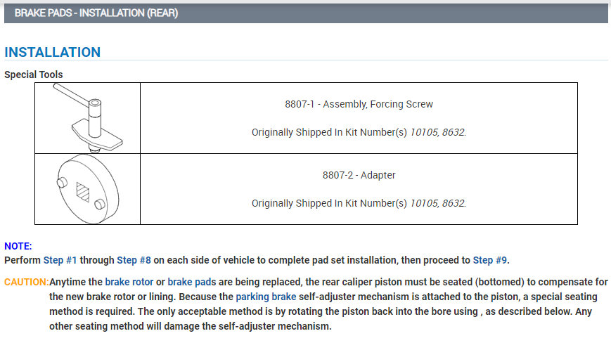

The other day while driving to work, I heard a grinding noise coming from left rear wheel. So I went to my mechanic to see what causing the noise. He test drive it and said that the backplate is causing the noise. So it looks like I need rear brakes and rotor can you help me please? Thanks and hoping for your most appreciated reply.

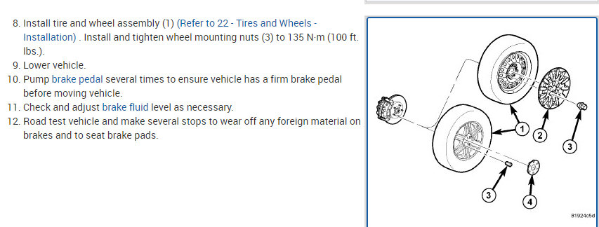

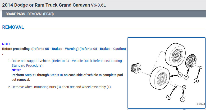

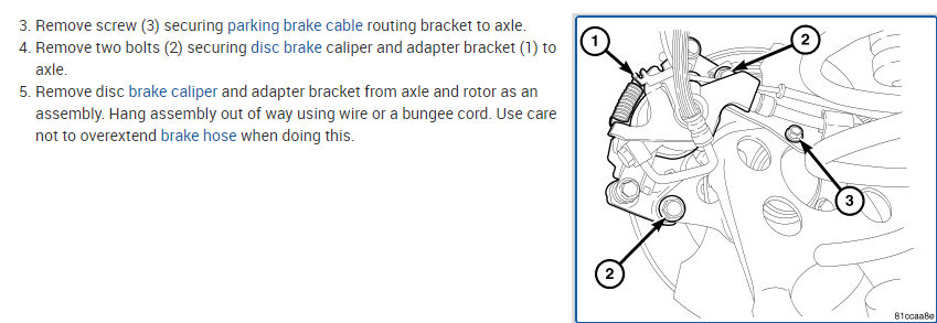

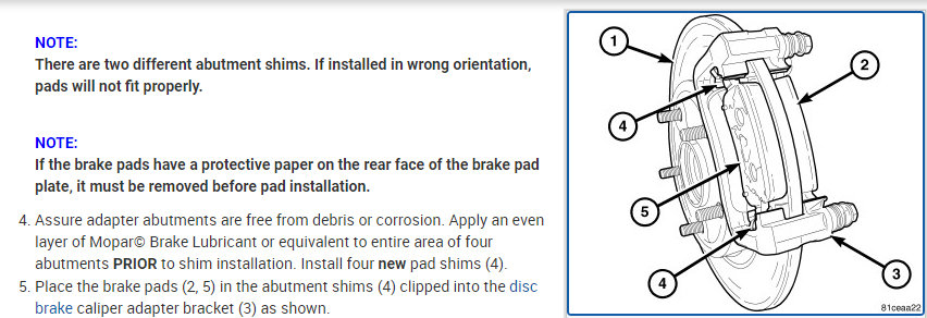

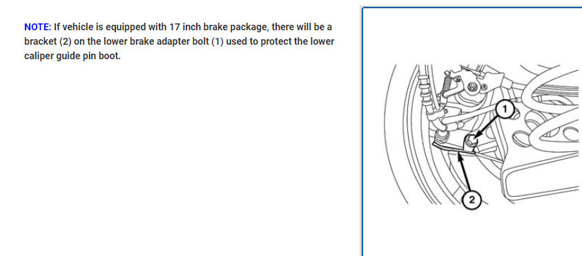

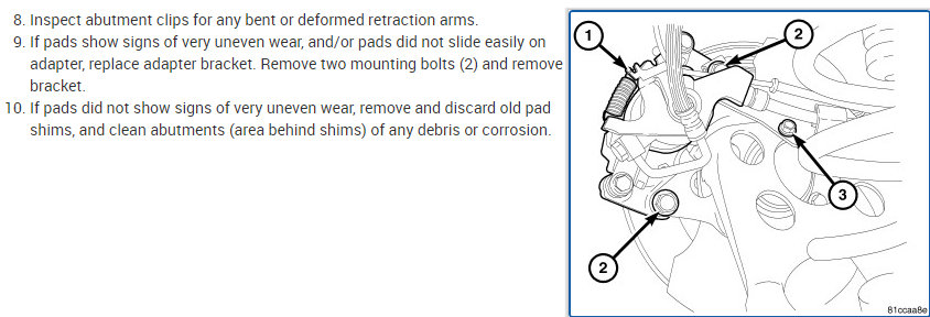

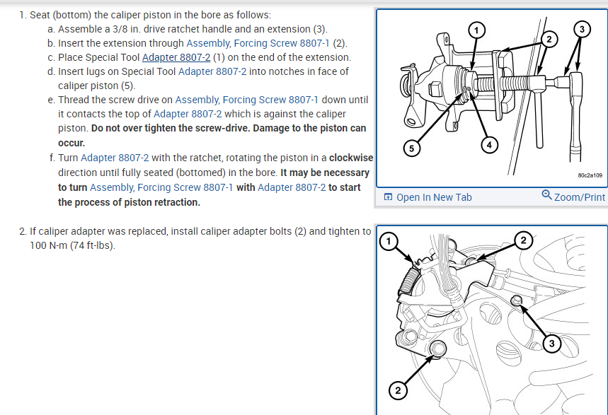

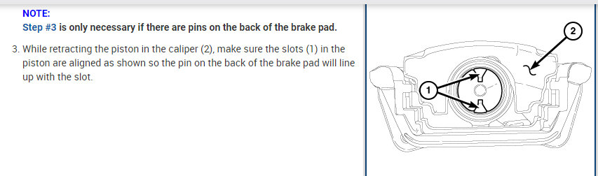

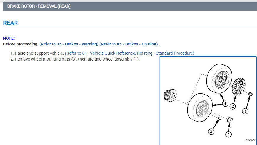

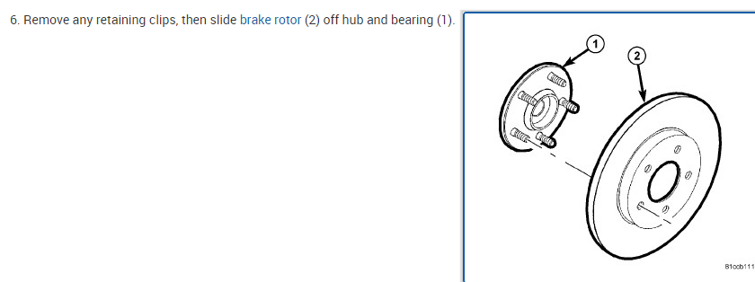

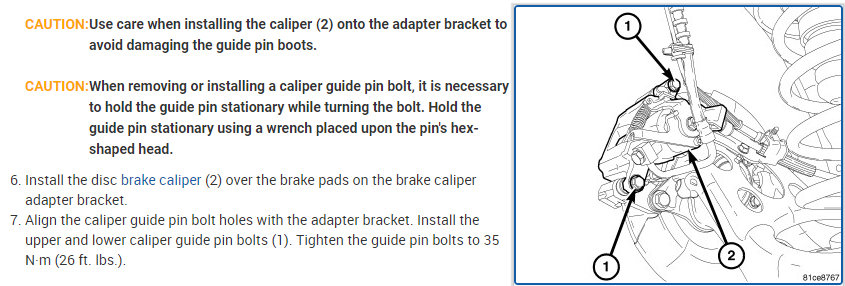

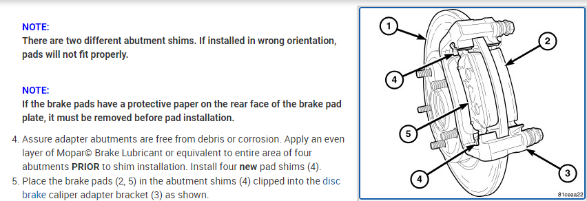

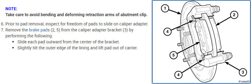

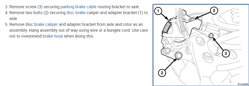

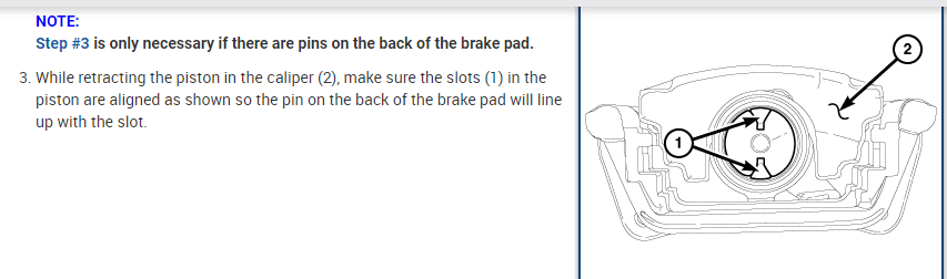

Here is the information you requested. This is a tutorial showing what is involved on how to change rear brake pads and brake rotors: Video then guide.
https://youtu.be/hPzxdnLJbhc
and
https://www.2carpros.com/articles/how-to-replace-rear-brake-pads-and-rotors
I've attached picture steps below on how to change the rear brake pads on your van. Hope this helps and thanks for using 2CarPros.
