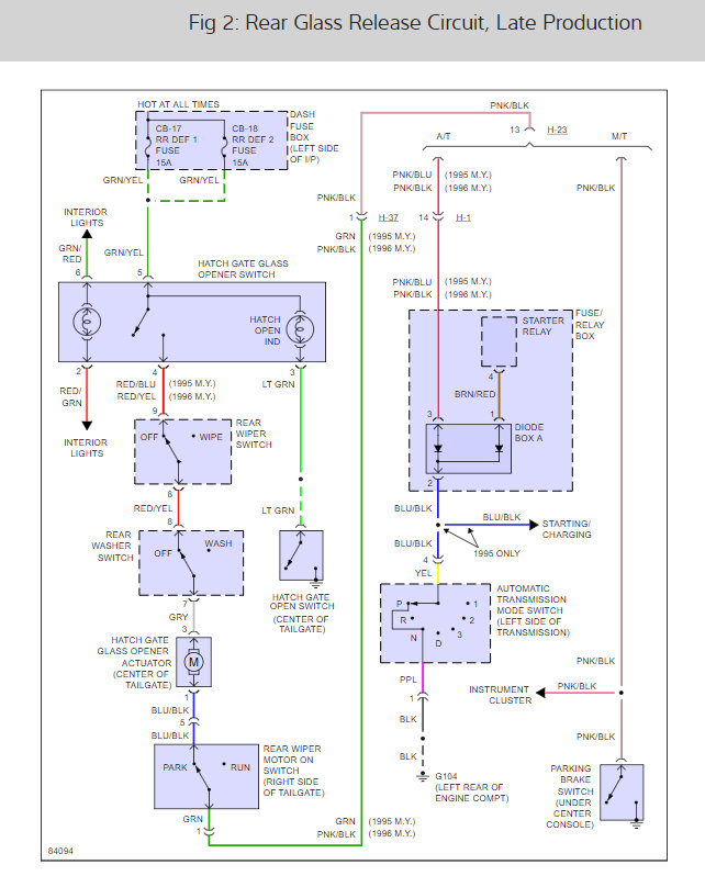

Back hatch will not open.
Oct 5, 2018 at 1:43 AM
Experienced Mechanic
55,649 POSTS

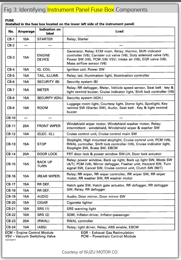

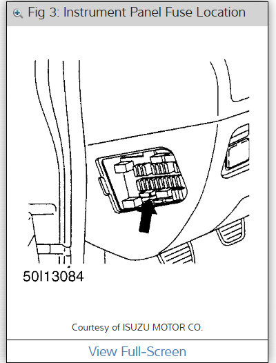

Lets check the fuse (CB-17 and CB-18). Here is the wiring diagrams so you can see how the system works and a guide to help check the fuses along with the fuse location:
