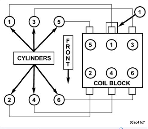

After installing new spark plugs, wires and a new coil pack, the engine is backfiring?
2007 DODGE CARAVAN
189,302 MILES • 3.8L • V6
LAURATROY05
I put new spark plugs and spark plugs, wires, and a new coil pack and now it's back firing... What could make it backfire?
Jun 26, 2023 at 9:44 PM
MATHGEN
  • 128 POSTS
Hi there. The first thing that comes to mind is crossed plug wires. I would double check to make sure the wires are connected in the right order. I have provided a diagram showing the correct firing order. Please let me know if you need any further help.
Jun 26, 2023 at 10:28 PM
LAURATROY05
Thank you... And I followed your diagram and the back 3 wires were crossed so now the car is running good.
