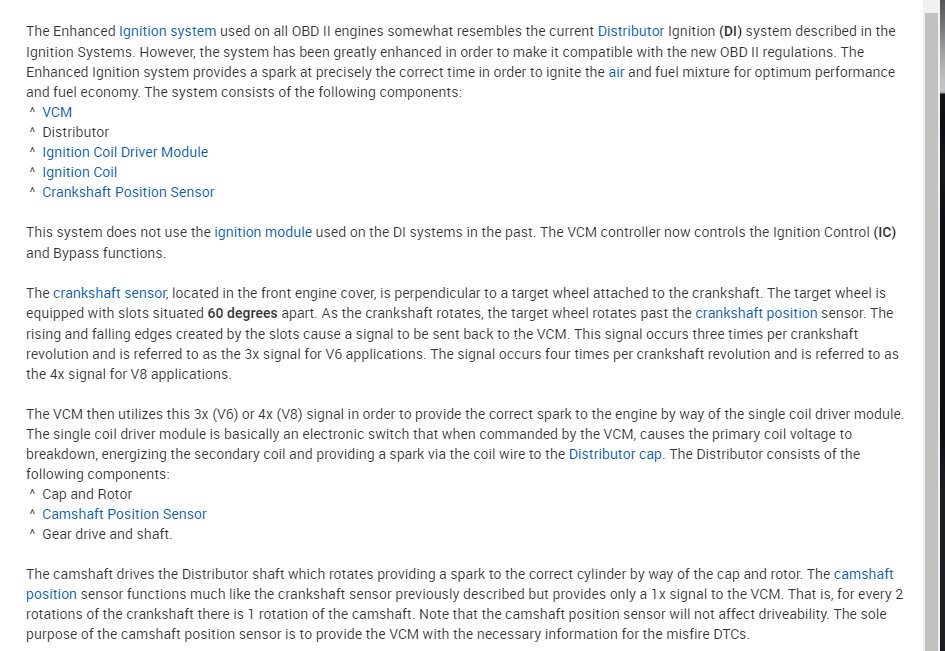

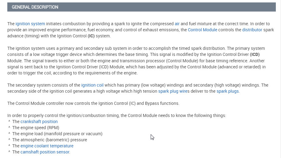

You have a distributor ignition so more than likely it is either mistimed or the plugs are 180 degrees off. Did you do anything with the timing?
Here are some guides on backfires. However, I suspect the timing is the issue so I would suggest advancing the timing just a bit and then restarting. It should start and run long enough to figure out any other issues.
