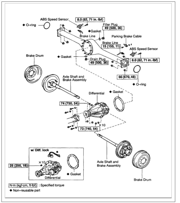

My car often makes a little vibration when the steering wheel is fully cut to left or right and brake released very slowly. If released braked and accelerated it does not vibrates. Vibration is from back. Back right axle changed but never checked fluid and it is LSD . Mechanic greased the drive shaft cross and checked back wheels in case they are not jam, please, please help me.
Secondly if parking brake or handbrake cable is not adjusted will it also vibrate from back? Please help mechanic took half of my life and money on this issue.

It sounds like you hit it on the money, the LSD must have special lubricant if not the car will vibrate at low speeds in turns. Here is a guide to help you see what you are in for when servicing the differential:
https://www.2carpros.com/articles/differential-service
Differential
Type Hypoid gear oil
Grade API GL-5
Viscosity:
Above 0°F (-18°C) SAE 90
Below 0°F (-18°C) SAE 80W or 80W-90
Here is how it will be on your car you can see the drain and fill plug in the diagram (below) Please let us know what happens.

Thanks a lot for reply Ken, bro the mechanic checked the oil and the oil was fine. I do not as he said, but I never changed oil so should I change the oil? Is it also of brake leathers or handbrake cable if not adjusted properly?

Check the real axle fluid level and condition. Replace the fluid if necessary. Fluid quality that has deteriorated can result in juddering when making turns as the fluid is not able to provide sufficient lubrication and protection against gears gnashing at each other loudly. This problem would be more common among LSD differentials.

Thanks for your reply. It often makes a little vibration when the steering wheel is fully cut to left or right and brake pedal released very slowly if released at acceleration it does not vibrates. Noise is from back right axle changed but never checked fluid and it is LSD.

You could have an axle bearing that is out. Here is a guide to help you get the problem fixed:
https://www.2carpros.com/articles/rear-axle-seal-replacement
