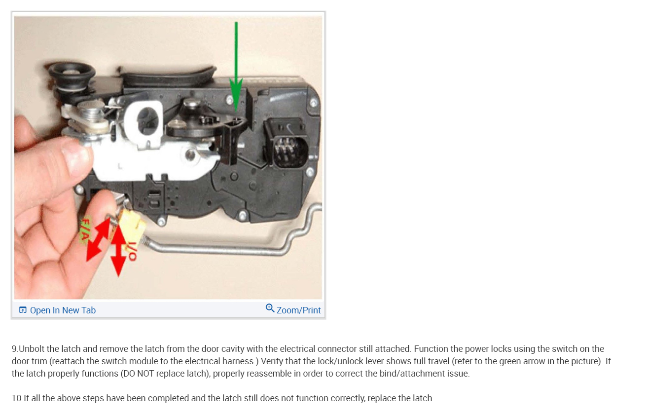

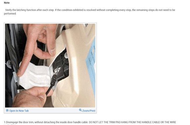

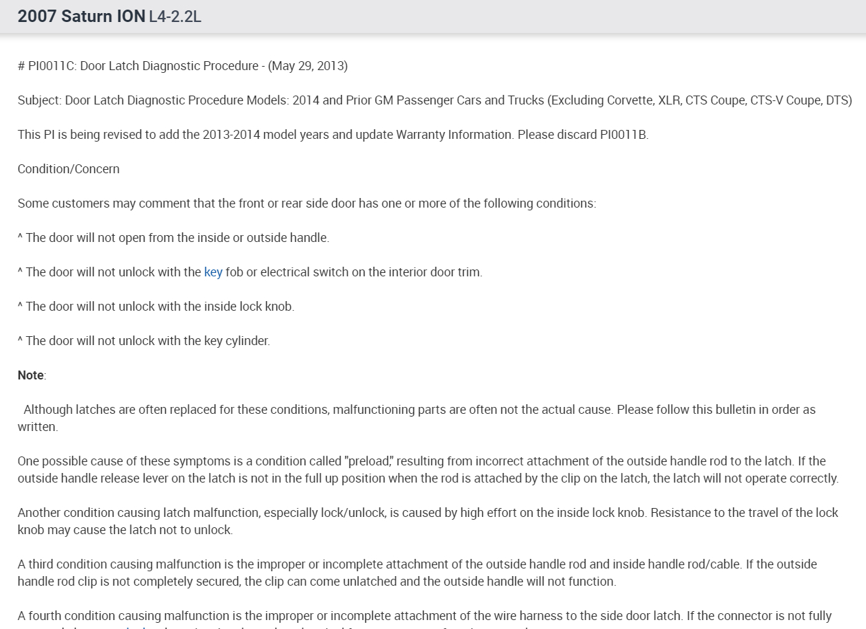

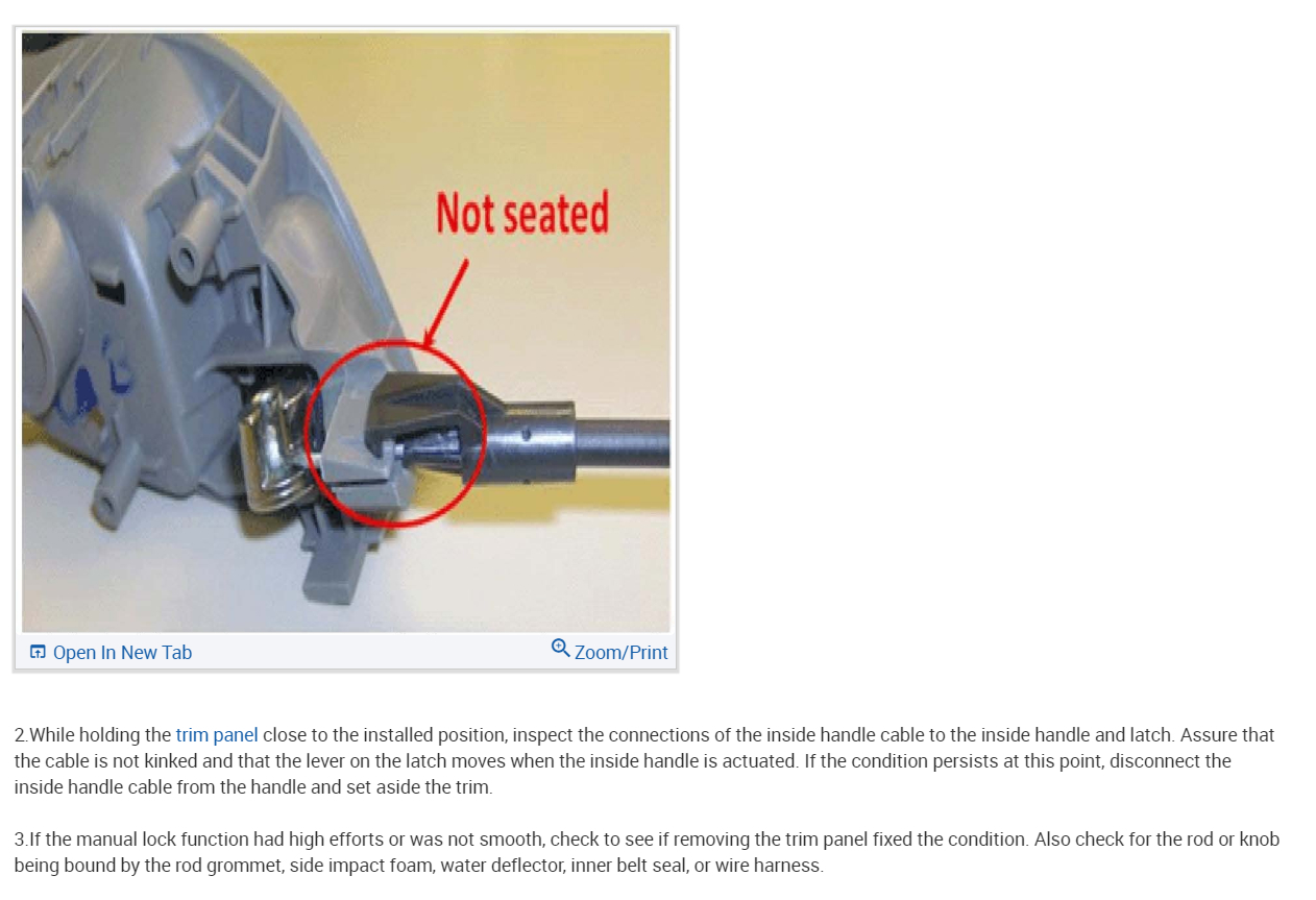

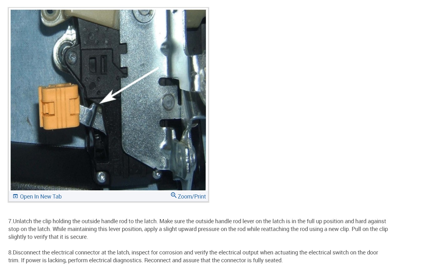

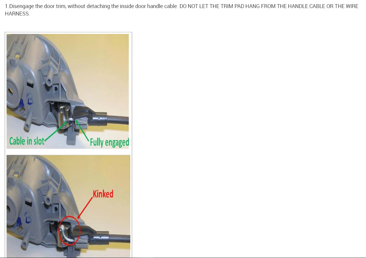

Car door won't stay closed. The other night car door swung open on me. Got it closed and immediately after the other door now won't stay closed.
Nov 19, 2019 at 11:36 PM
  • 55,433 POSTS
It sounds like the latch is worn out. here are the instructions on how to change it out in the diagrams below. Here is a bulletin on the problem you are having. Check out the diagrams (below). Please let us know what happens.
