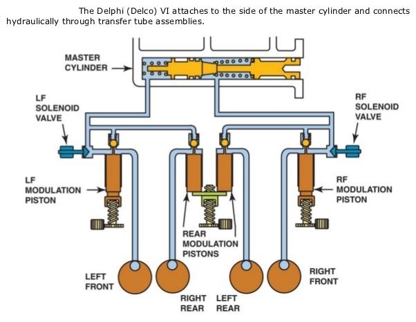

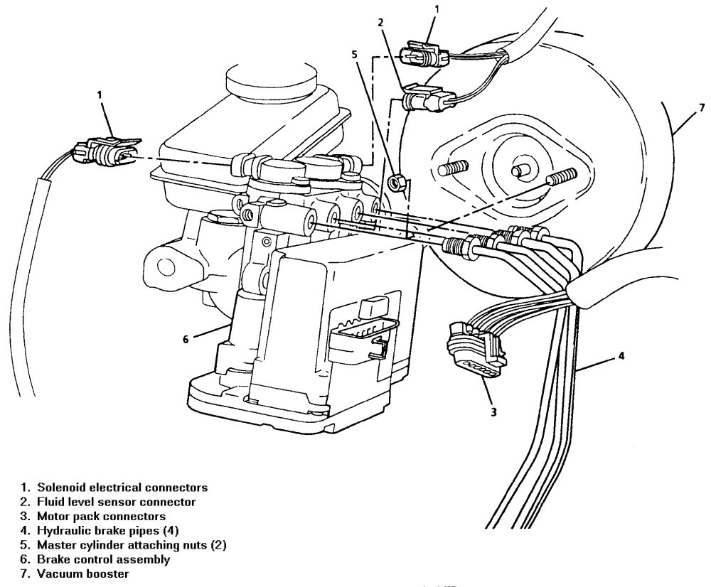

The rear brake lines on my Lumina i changed and would like to know where they hook up? which wheel hooks up to which hole on the master cylinder?
Jun 23, 2017 at 11:32 AM
STEVE W.
  • 15,392 POSTS
Normally if I replace lines I do it one at a time and just follow the originals to the proper ports. You should have four lines one to each front wheel one to each rear wheel.
The images should help, They show the lines and connections.
