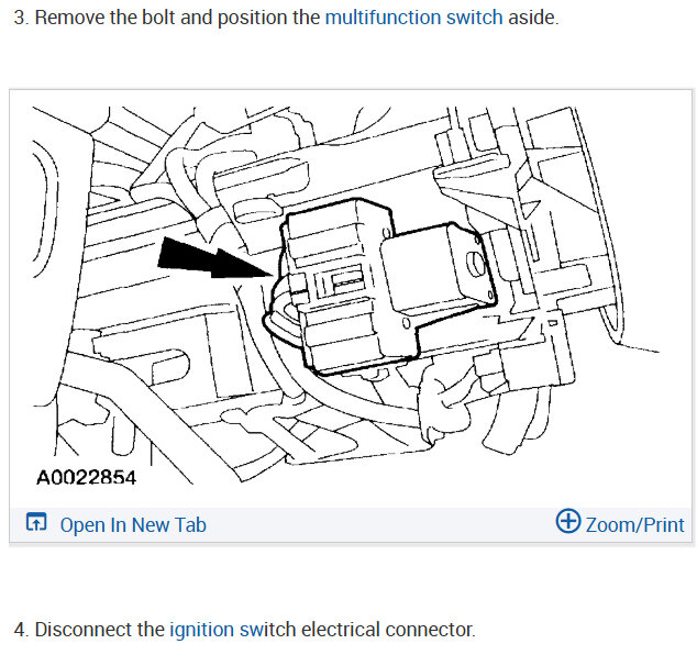

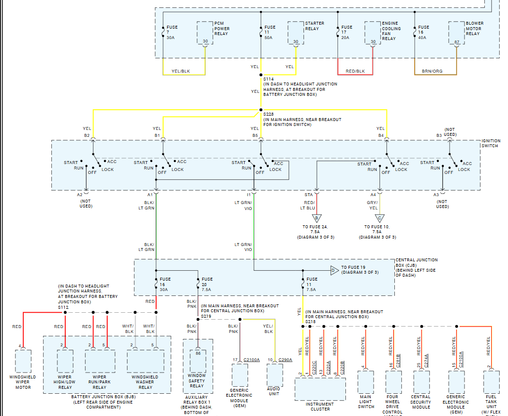

Hello I'm looking for the ignition switch wiring diagram to troubleshoot the b1359 code.
Jul 28, 2025 at 1:44 PM
Experienced Mechanic
55,710 POSTS
Yep, good call, it looks like the switch is bad.
B1359 - Ignition Run/Accessory Circuit Failure
Here is how to change the switch out and the wiring diagrams as requested. Check out the images (below). Let us know if you need anything else.
