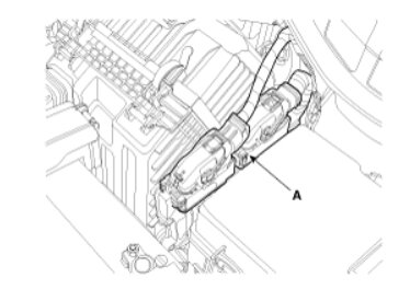

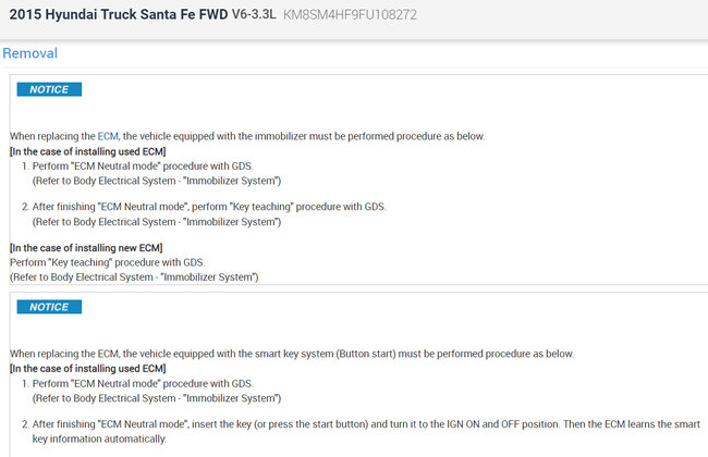

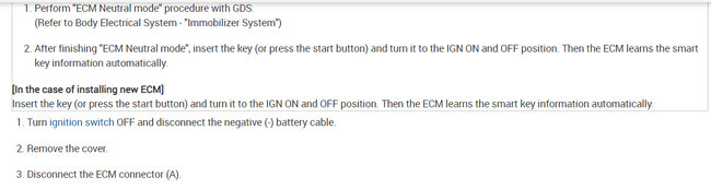

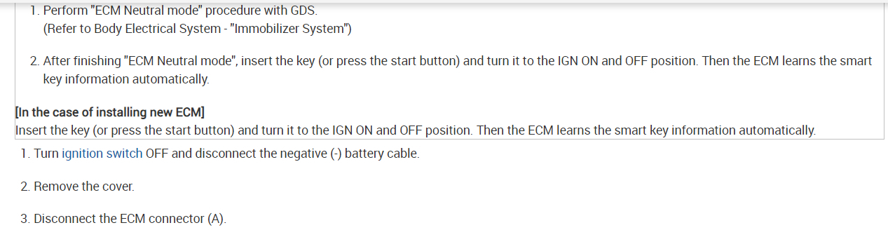

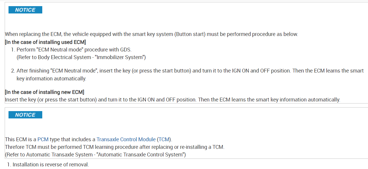

The first thing is the ECU issue, the code says it is bad but I have had good luck having the ECU reflashed. A shop will need to do this for you or you can get get a preprogrammed unit by searching Google or Ebay.
B1010 Code - ECU Malfunction
P0340 Code - Camshaft Position Sensor 'A' Circuit Malfunction

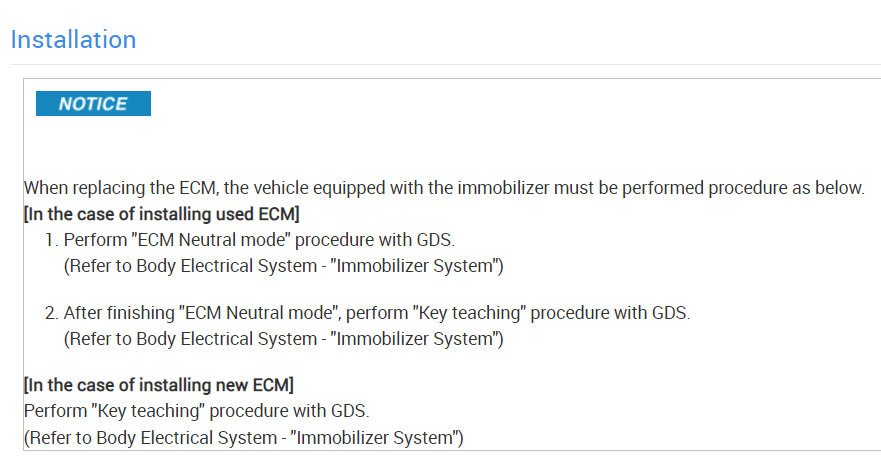

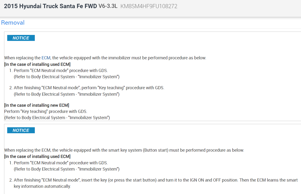

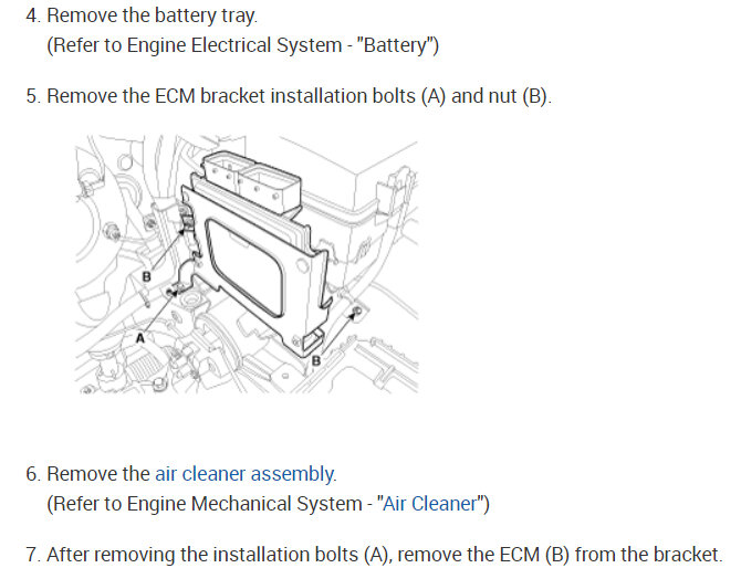

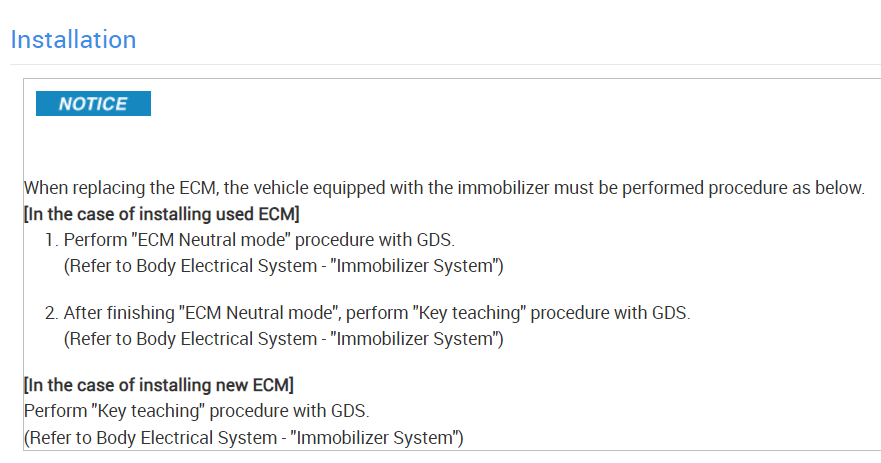

Here is the location of the ECU so you can swap it out, also I would remove the electrical connectors and plug them back in to help fix a potential bad connection, check for corrosion as well. Check out the images (below). Please let us know what happens.
Sep 23, 2024 at 5:34 AM
ANDRIN ATEM
  • 409 POSTS
I swapped the ECU, the problem remains the same. Please the 3 wire camshaft sensor signals will help if I can know what voltages and signals I am supposed to get.
