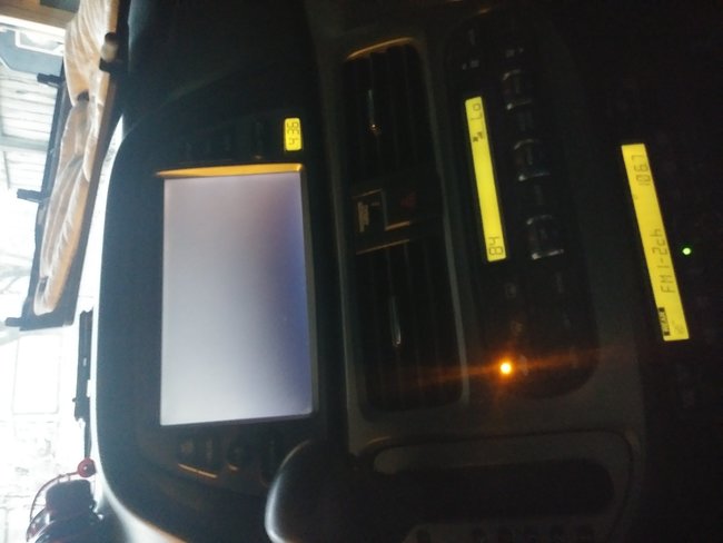

Thank you! I will let you know what the outcome is. On a separate hopefully unrelated. The navigation screen, it comes on but is completely black. I can see its on because it lights up but nothing displays. There is no DVD or PC card in the DVD Navi unit. Does there need to be for it to turn on? And was wondering if that is why the back up camera doesn't work?

Hello again,
Okay, I have included the information you requested in the diagrams down below. I hope that the Troubleshooting guide on the Navigation System is helpful to you. Please be patient and go through it thoroughly, as there is a lot of information there to digest. Let us know what you find out and if there is anything else we can help you with.
