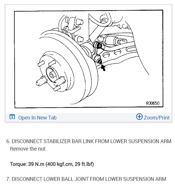

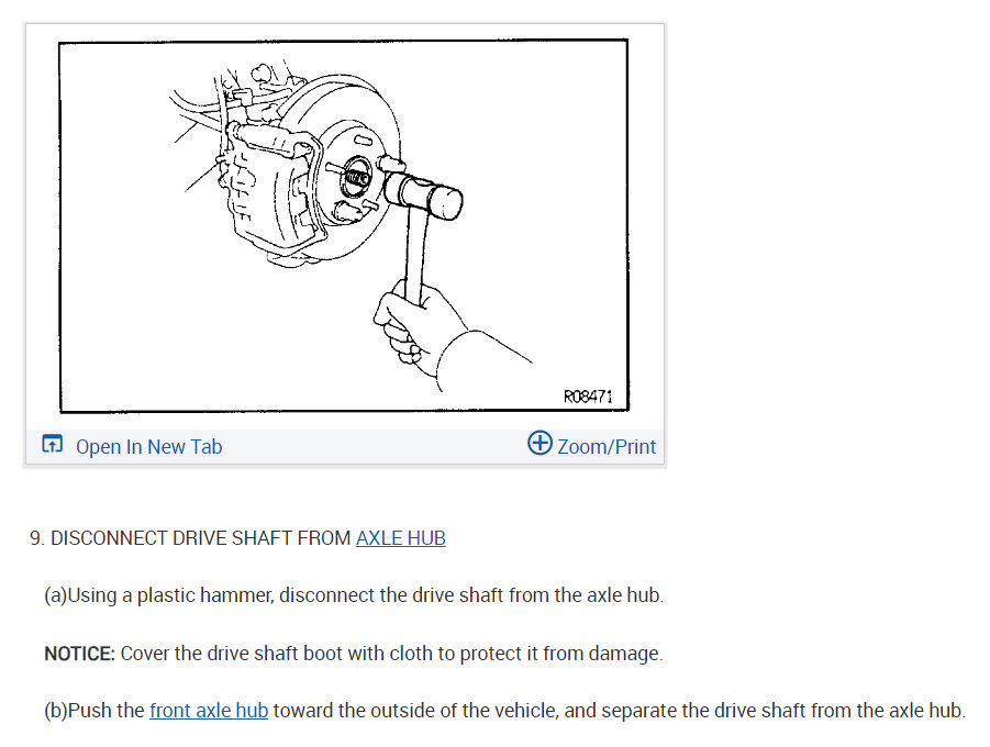

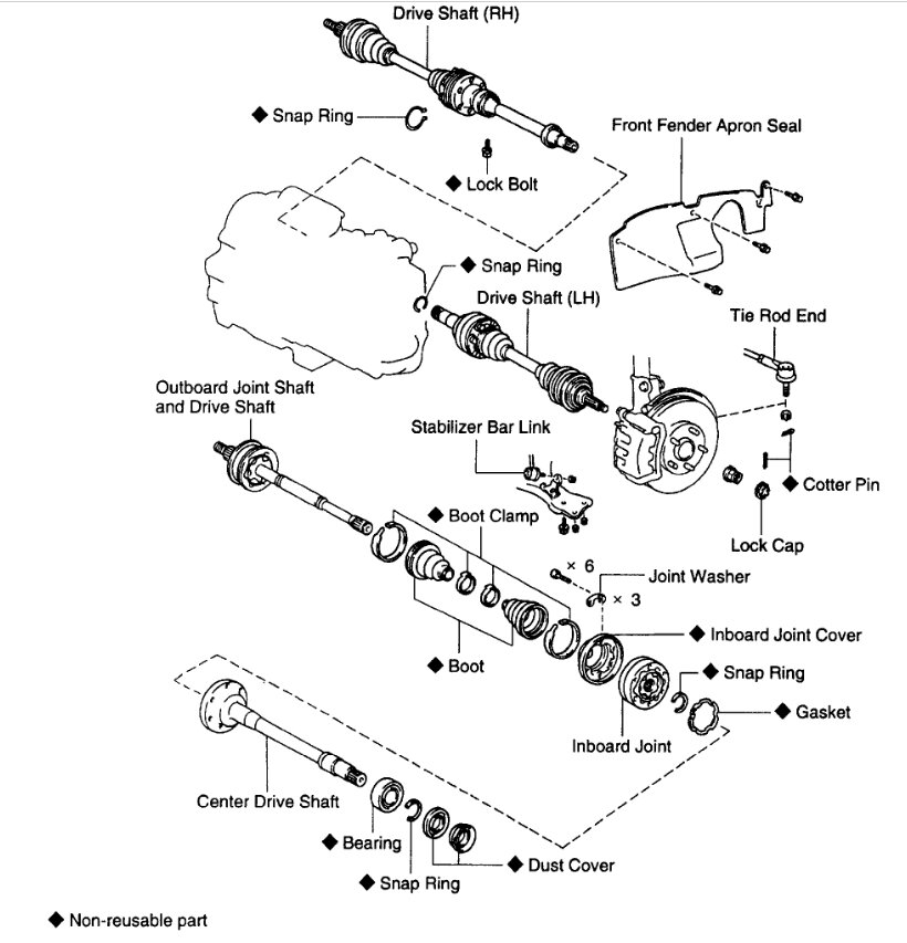

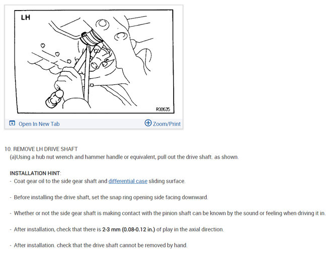

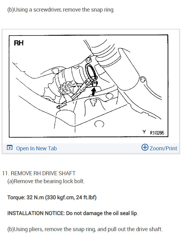

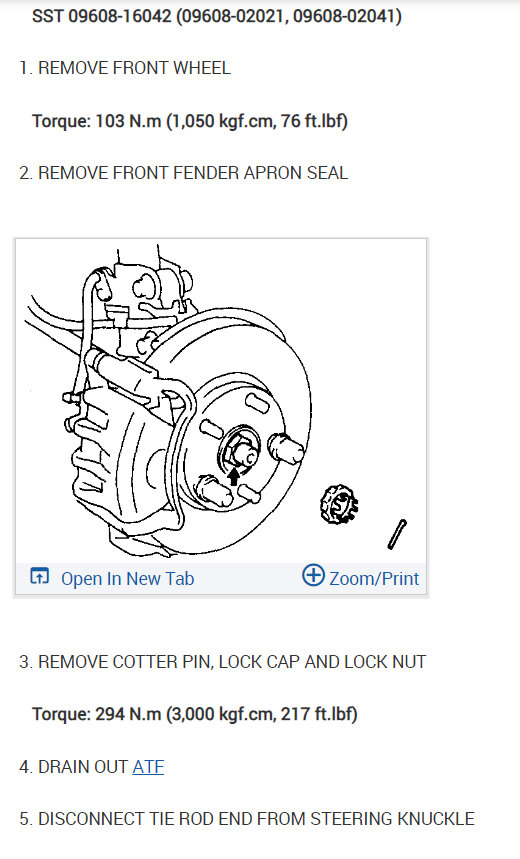

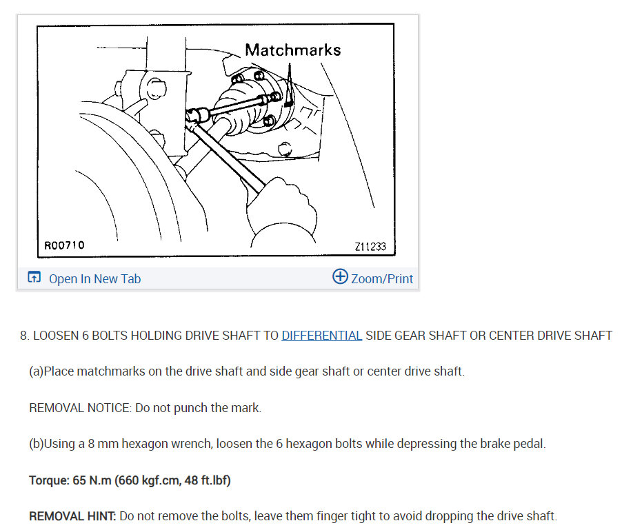

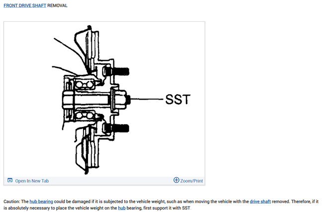

I'm going to be replacing the CV axles on my vehicle listed above and I need the torque specs for the axle and wheel bolts, as well as any suspension bolts, I'll be loosening. I don't have a manual for this car anymore. Thanks!
Nov 27, 2023 at 4:39 AM
  • 55,433 POSTS
Hi Ryan,
Here is the instructions and torque specs for replacing the CV axles on your car. Check out the images (below). Let us know if you need anything else.
