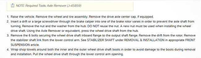

does the right front axle shaft pop out of the carrier like the left side did and if so is it okay to use a slide hammer on it or do I have to take the axle tube off? is there a special sealant to use when putting the axle tube back on the carrier case? replacing the axle seals.

see picture for how to remove axle shafts. normally a large pry bar will pop it out from case or tube. the seal should always be replaced while shaft is out. It is cheap and easily done.

Yeah I don't know what happened, I don't see a picture. I tried a pry bar and it started to booger up the axle tubes the end. So do you think its ok to use a slide hammer?

ya a slide hammer should work. i'll send instructions again. it is not a pic just how to do it out of manual.
