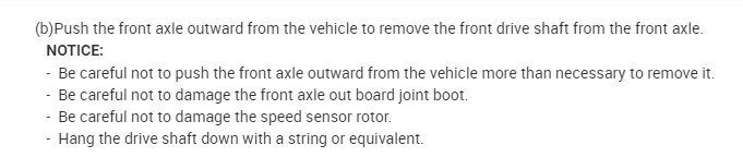

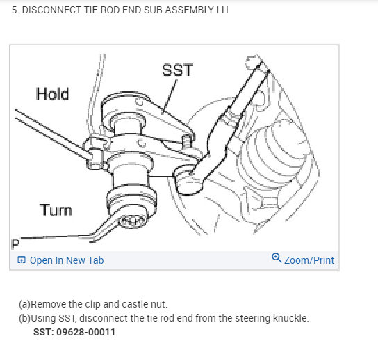

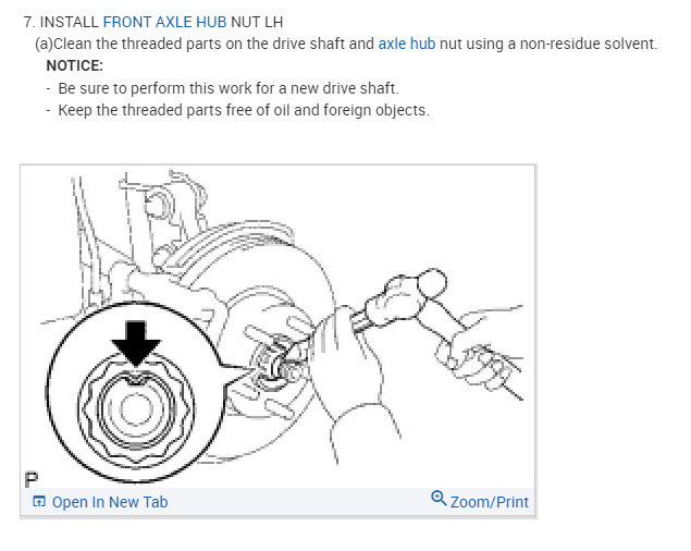

Cv axle replacement for passenger side please.
Sep 5, 2022 at 5:34 AM
  • 110,244 POSTS

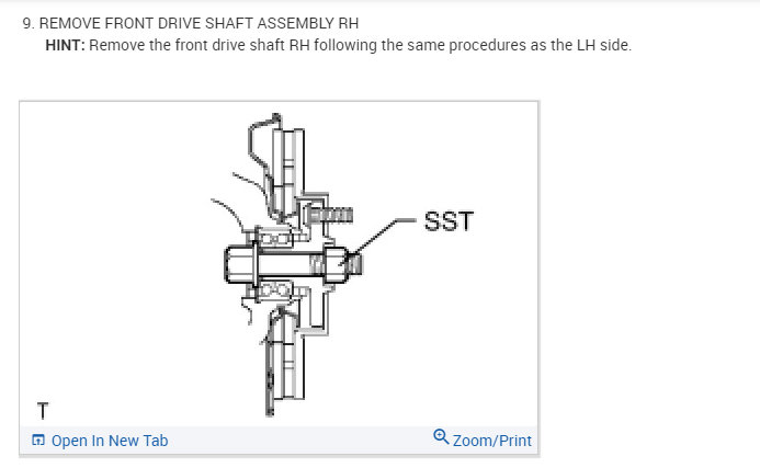

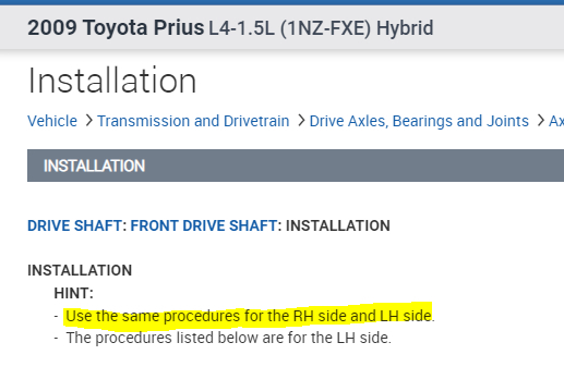

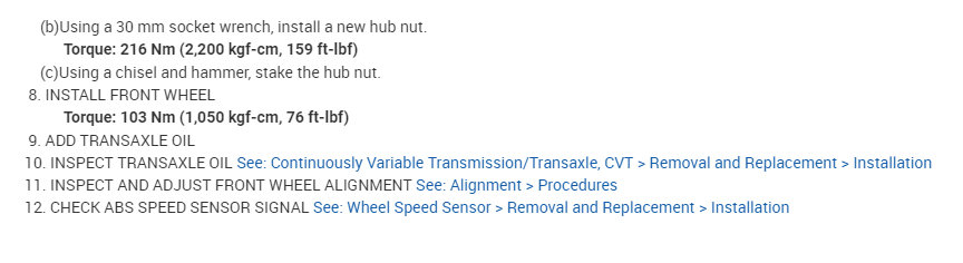

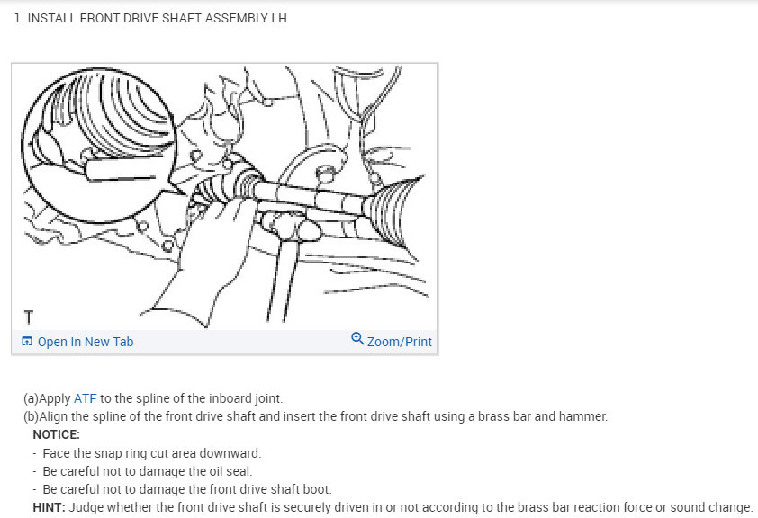

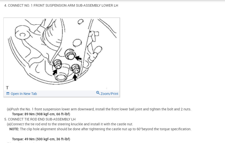

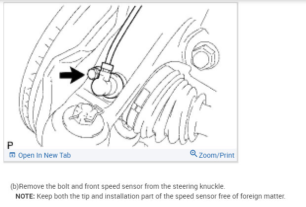

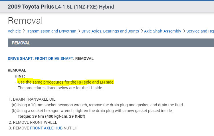

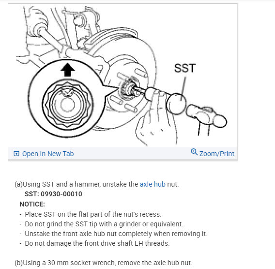

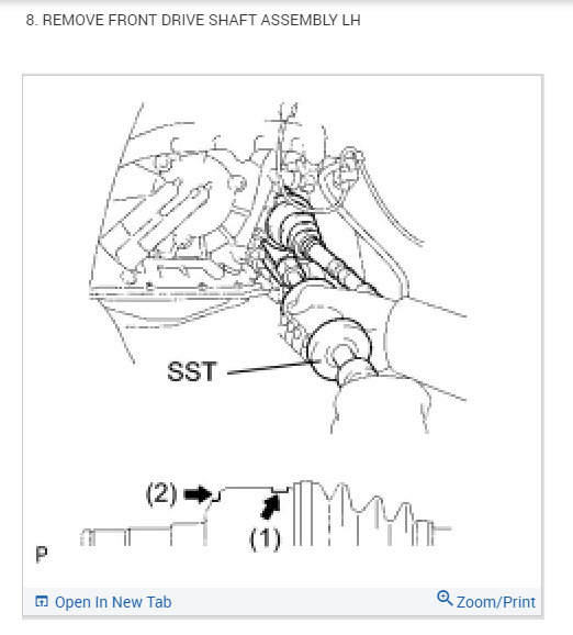

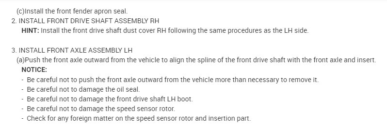

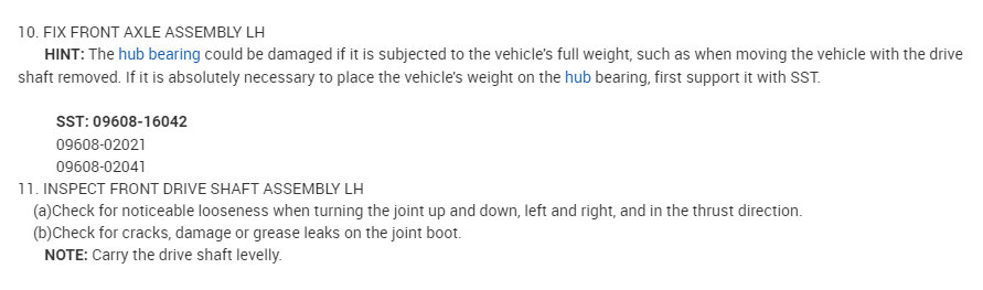

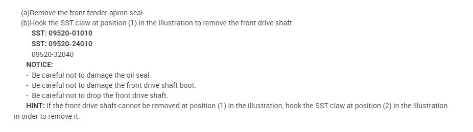

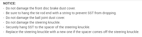

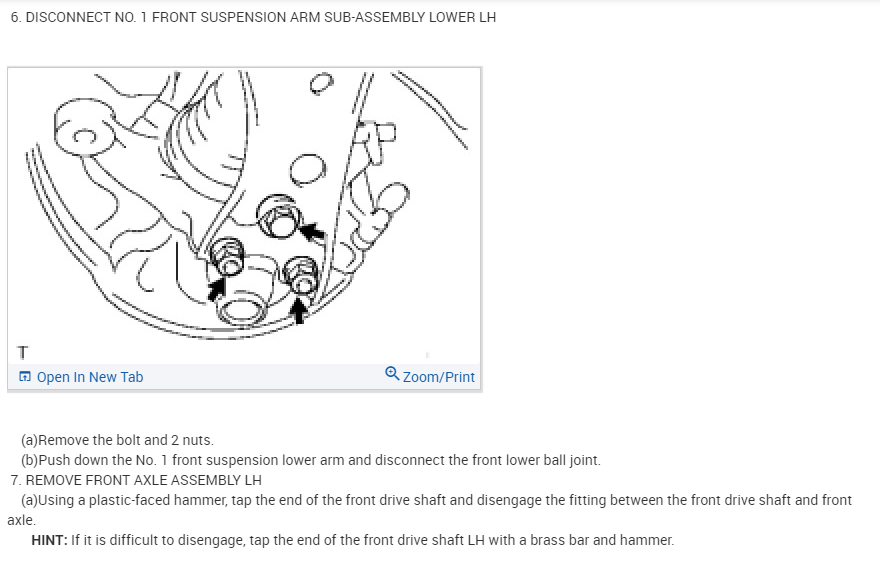

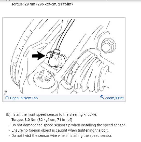

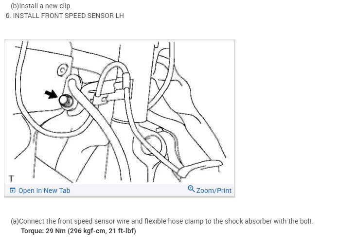

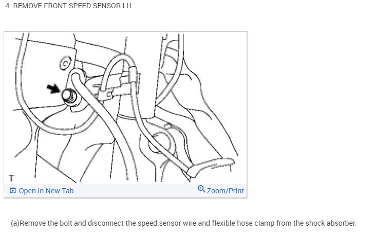

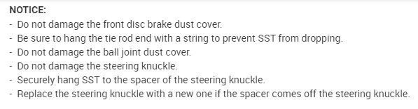

I attached the directions below related to the drive axle replacement. You indicated the passenger side. The directions indicate the same procedure for both the passenger and driver sides of the vehicle.
Take a look through the directions and let me know if you have questions.
