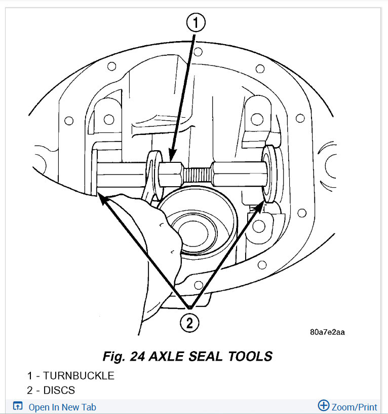

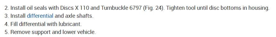

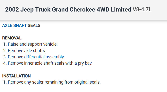

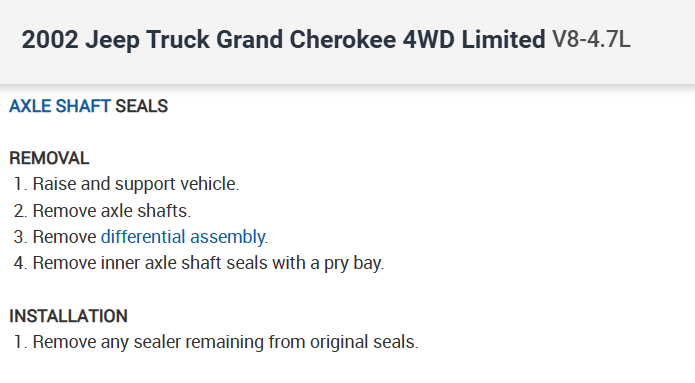

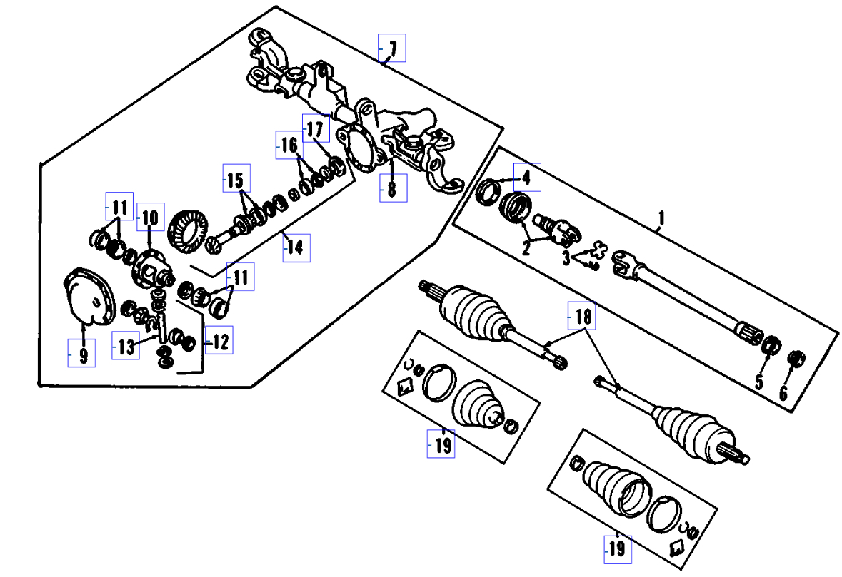

front driver side axle oil seal is leaking. It's leaking on the wheel rim. I would like to know the procedure for how to replace it and also the weight of gear oil I need to use.
Thank you
Nov 22, 2024 at 6:42 AM
  • 55,647 POSTS
Okay, this is a job, the front differential needs to be removed and disassembled. The axle seals are internal and are one of the last parts to be removed when the differential is taken apart. Check out the images (below). Please let us know what happens.
