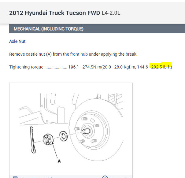

A friend had a small fender binder, scuffed the fender onto a truck bumper which caused the wheel to bend, broke the caliper line, knuckle, axle came apart from inside boot and bent the stabilizer link. Changed all parts and all looked good. Upon putting the car in drive while wheel still on stands there was a whine noise and a bit of grind while putting it into drive, let the wheel turn but i doubt it did, then turned car off and found inside boot grease all over. I am thinking either i tightened the axle volt too much or didn't insert the axle all the way in from the inside side. What is the torque on axle bolt from rotor side? When i inserted the axle i hammered it from the outside side where the nut goes in, not sure if that could cause any damage to the inside boot, which i doubt as i installed several axles before.

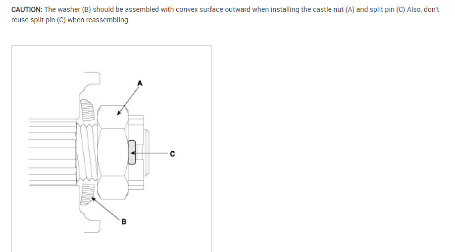

I attached the torque specs below. When you say you saw grease, is it from the CV joints? Also, if you hammer the axle hard enough, it will damage the joints.
Take a look through the directions below. Let me know if that helps.

Yes, it's from the inner CV joint. Seems like the inner part of the CV joint was moving i guess but the outer wasn't so it twisted, could also be a crappy aftermarket one. Well, how else can i install it if i don't hammer it? I didn't notice a concave washer like they say here but ill double check. I ordered another one.
