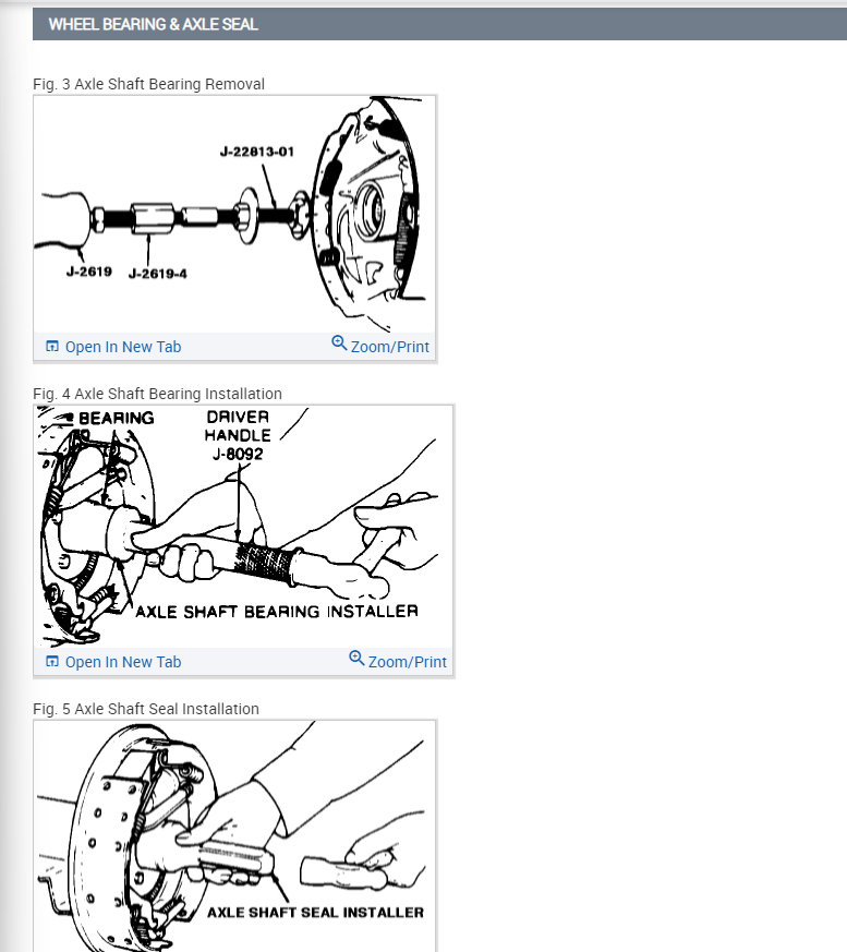

Installing a posi unit in a 10 bolt 8.5 and before pulling axles I checked for up and downplay and there was just a little.
Since the seals had been leaking, I purchased seals and OEM and bearings.
When I slid the bearing on the axle it still had play.
The axle looks good with no grooving, I measured the axle and it's 1.618 which from what I've found is correct for a new axle.
Is a little up and down okay, and how much would be excessive?

You should not have any vertical movement. So, if you do then we need to find out how much and that will help figuring out what the issue is.

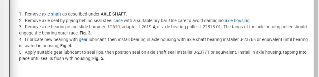

https://www.2carpros.com/articles/how-to-replace-a-rear-axle-bearing-and-seal-3-4-and-1
Most of the time when I have found vertical movement it is due to a bearing issue but if you have replaced this and the axle then the most likely issue is the housing.
However, I would suggest with checking the amount of movement that you have to make a better decision on what to do. You do this using a dial indicator in the 12 o'clock position on the axle flange and then move it up and down and see how much you have.
There is a chance that the axle or bearing is not machined correctly. If you measured the axle shaft and it is correct, then the bearing may not be correct.
Do you have part numbers of the parts you replaced?
Let's start with this info and go from there. Thanks
