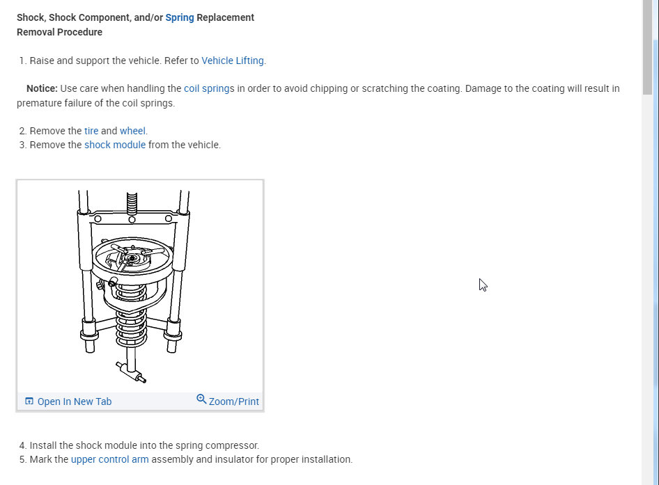

Front passenger wheel bounces really bad
2005 CADILLAC STS
110,000 MILES
POOKIEHENDON
When I turn, it goes up and down like the wheel is going to come off.
May 19, 2020 at 2:02 PM
It would help if we could see a video of this just to be sure. but it sounds like the shock/strut is weak allowing the wheel to bounce more then it should. However, if we see it we may be able to better assist because this could be way off.

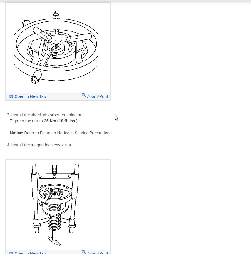

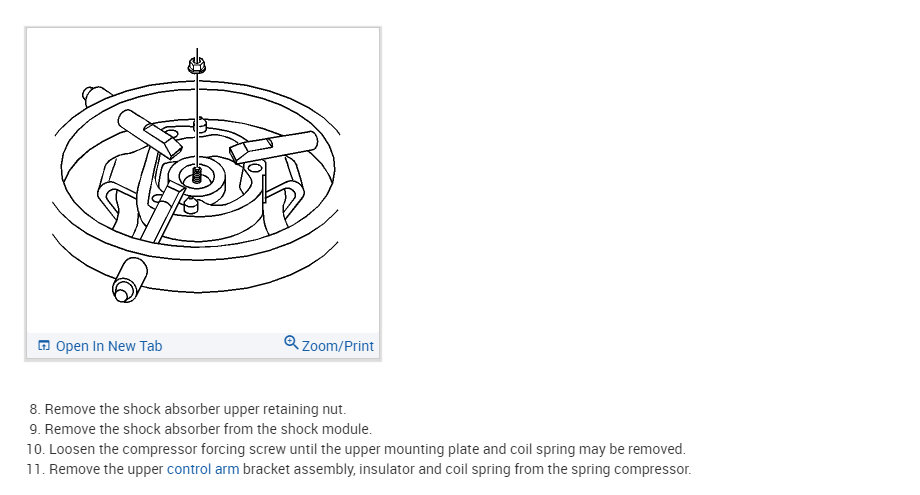

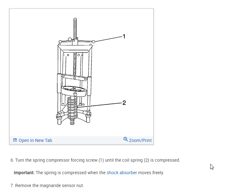

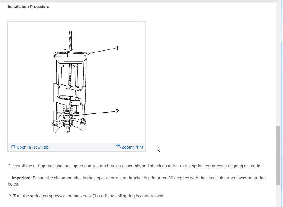

I attached the process on how to replace a shock if this is what it is. Thanks
