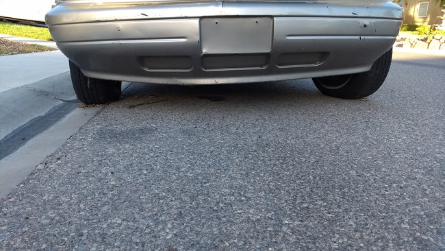

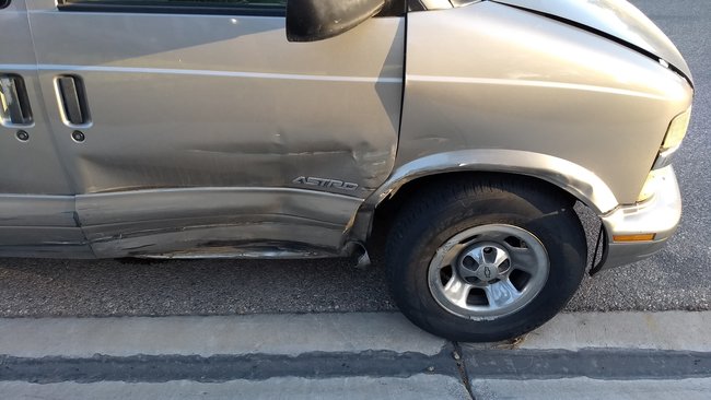

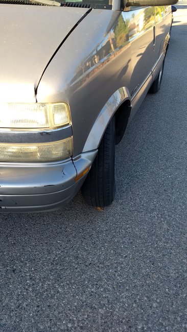

A couple months ago I got in a wreck. This caused the front two wheels to be bent in wrong directions. Does this mean that the axle is bent?

Here are more pictures. (This is when the steering wheel is straight)

It looks like you have a bent tie rod, you will need to raise the car for inspection to be sure.
Here is a guide that will help you:
Then check the suspension out using a flash light.
Here is a guide on how to change a tie rod if it ends up being that:
https://www.2carpros.com/articles/tie-rod-end-replacement
Please let us know what happens and upload pictures or videos of the problem.

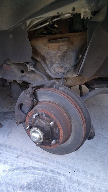

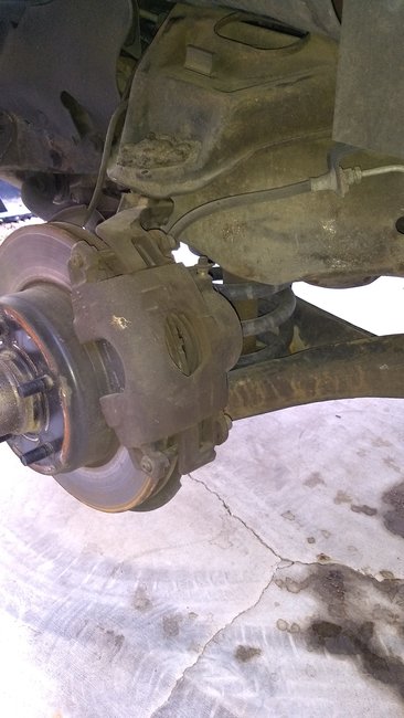

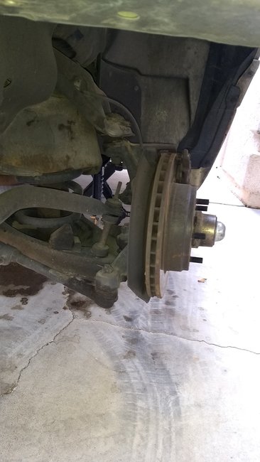

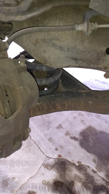

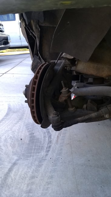

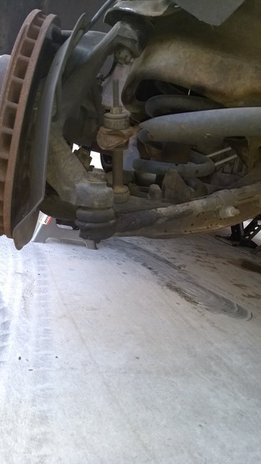

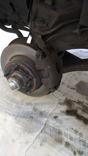

I lifted it up and here are some pictures behind the wheel. Thanks so much for getting back so quickly!
Oct 12, 2017 at 5:10 AM
  • 55,766 POSTS
Can you get more around to the front of the steering try to get some straight on shots?take as many as needed.

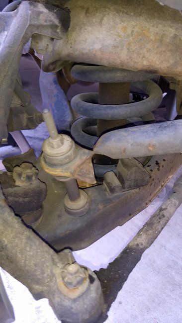

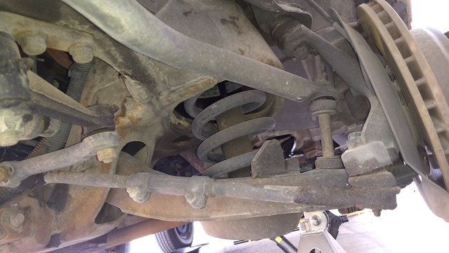

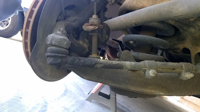

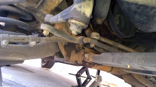

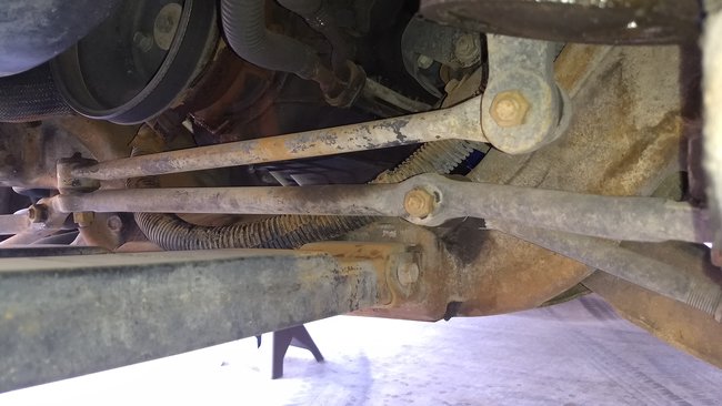

More pictures! I took of the bumper so I could get a better view. I see that a metal pipe that goes from one wheel to the other is broken. Could this be all it is?
Oct 13, 2017 at 1:32 AM
  • 55,766 POSTS
I see the sway bar broken, but that will not cause the wheels to be so far off. It looks like it is a tie rod or spindle is bent. Do not like to ask this but can you get more shots of the tie rods and center links? You have enough of the spindle area.
I cannot get an eye on whats causing it specifically.

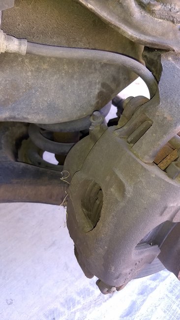

More pictures. Are these what you are looking for? Thanks!
Oct 13, 2017 at 3:47 AM
MHPAUTOS
  • 31,937 POSTS
The trouble is it is very hard to see a small bend in a photo. There may be a problem with lower control arms as well. A first hand inspection is always the best method of dealing with these types of problems, also having the front end checked on an alignment machine will pick up all errors in alignment geometry that the eye cant pick up. if the car can be transported to an alignment center this would be to your advantage in locating all problems affecting the cars steering and suspension.
Oct 13, 2017 at 11:04 AM
  • 55,766 POSTS
I was hoping we can see the bend since it is so obvious, but MPautos is right little bends are hard to see. Can you see anything that is bent or?
