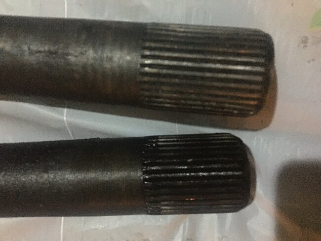

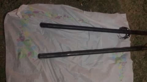

I have used e450 ambulance listed above. i had the left rear axle broken i about i used one it is the same length about 1.10 meters, but it seems the end gear 1 centimeter than original on is it save to use it fit fine but am not sure if it is okay. i hope I explained my problem right i will post the pic. The first in pic is the original.

If I understand, the replacement axle is 1 centimeter shorter. Is that correct? If that is correct, that means the splines that go into the differential are a centimeter shorter. That would likely cause a slight change in strength.
Is the axle the same diameter? Is everything else the same? Did everything bolt together properly and securely?

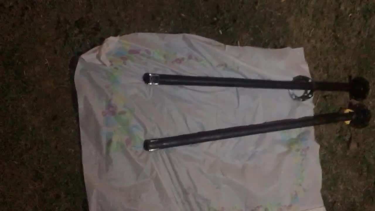

Today I measured it again the splines in the original is 5 cm long the other i bought is 4.5 cm but other than that everything is the same I installed it fitted ok i drove no problem no noise or felt any change ( I don't know if it's okay) or i should buy the original one and if i can ask a favor under what code or part no is original axle?

I don't have the OEM part number. Sorry about that. However, if it is only 0.5 cm different, it should be fine. If you drove it and all seems okay, it should be. Just pay attention to see if you notice any odd sounds.

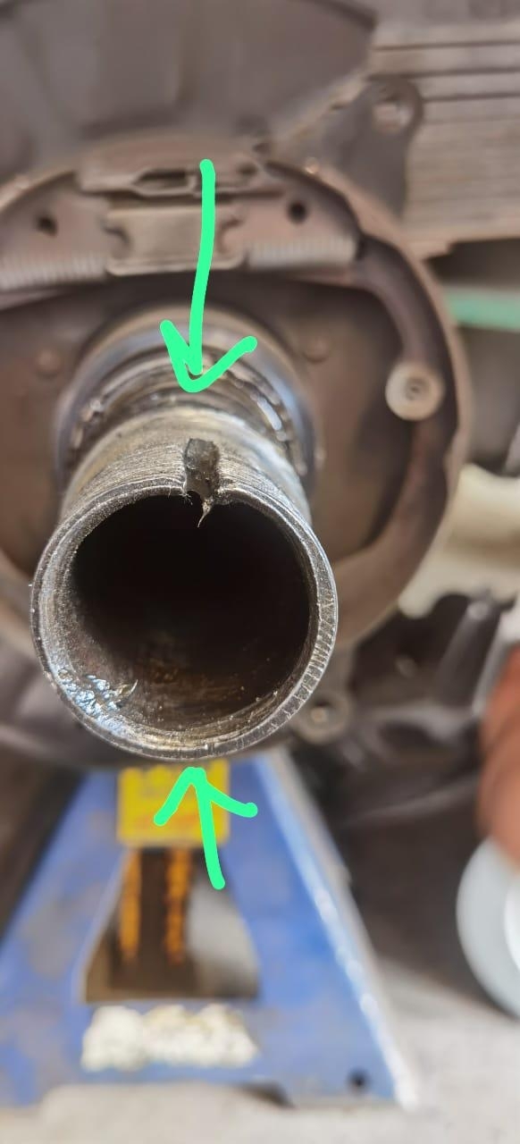

Hi again Joe, sorry for delay i was busy i took my car to body shop to lubricate bearings in rear axle but when he could not use the outer bearings it did not locked well in the spindle he advice to remove the whole differential and take it to lathe jop to fix the spindle and but it back again i didn't like this am not sure if the spindle welded in differential is there possible way to move the spindle only or i should do what he say

Looking at the picture, which does need attention, but it's hard to tell for sure looking at it from one angle. If it is as rough as it appears, I would have it repaired before putting things back together.
