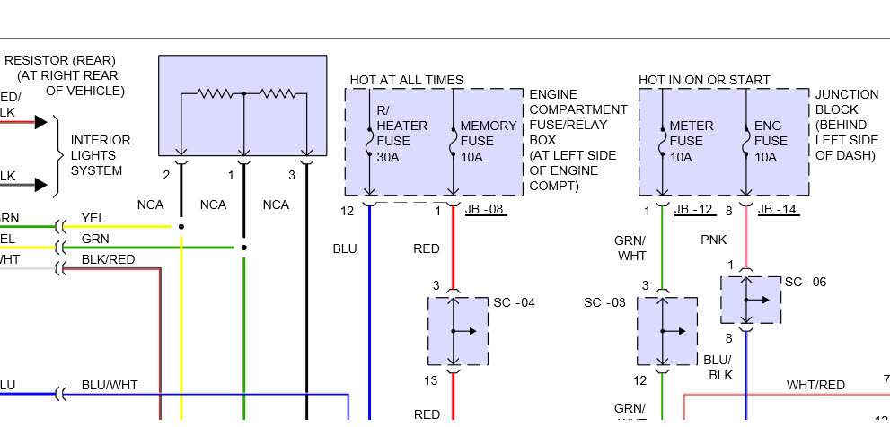

Air conditioner light does not come on and no control of air flow position.

Check fuses and relays under hood and ones in picture. Then scan for codes you will need a professional style scanner for this.
Image (Click to make bigger)
