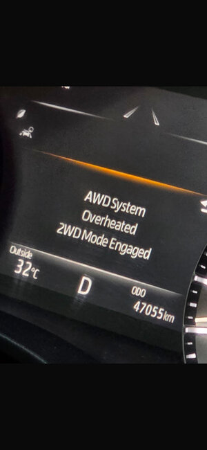

Hi dear, please can you help me this puzzle, I can’t find the AWD and the abs on the gateway network when scanning this car. Also a message shows on dash AWD overheating 2nd engaged. Am going to attach an image below on the dash warning message.

This message does NOT always mean actual overheating, it often means:
“I can’t communicate with the module that controls AWD, so I’m disabling it.”

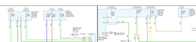

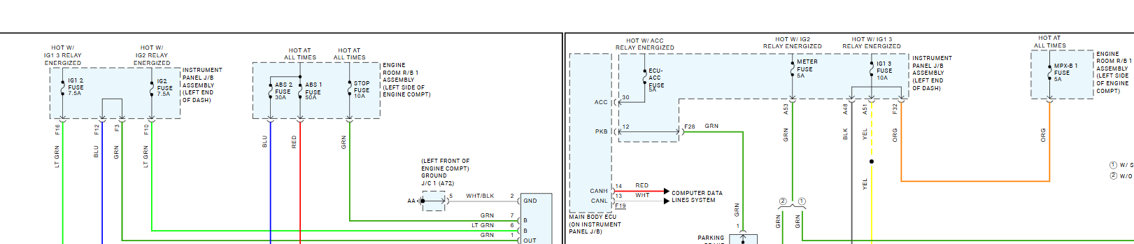

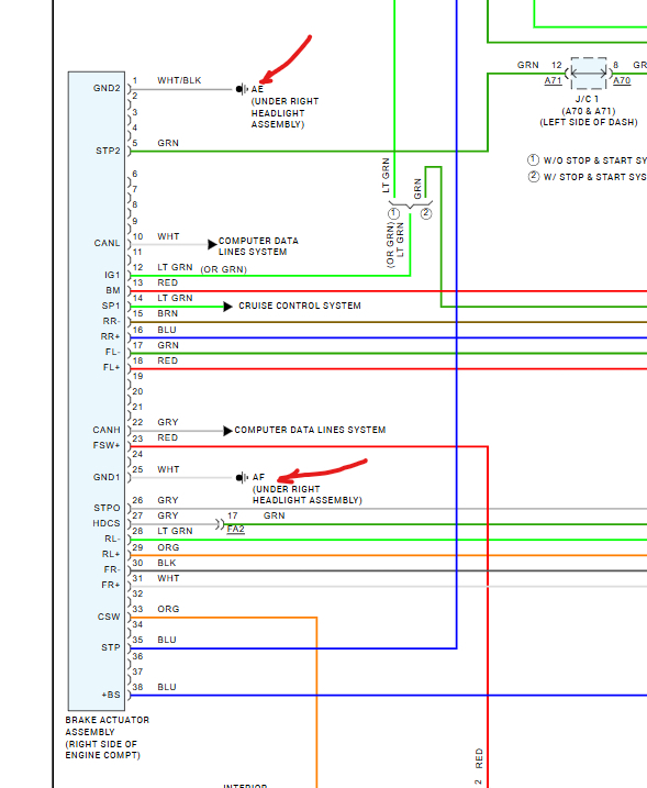

I would check the fuses and the ground to the ABS module and if they are good replace the the module. Here are the fuses you need to check and the grounds for the system as well. Check out the images (below). Let us know how it goes
