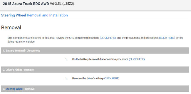

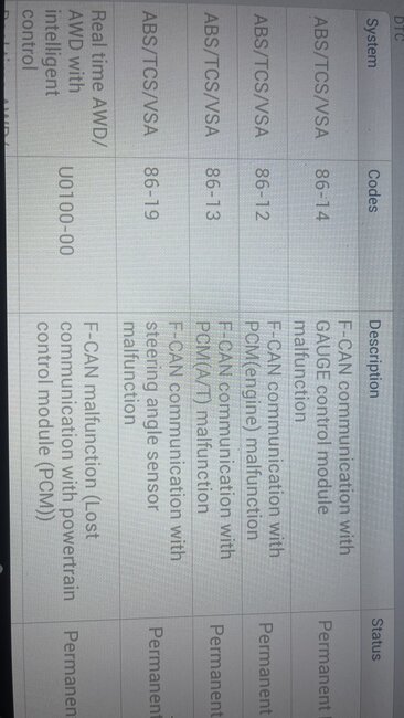

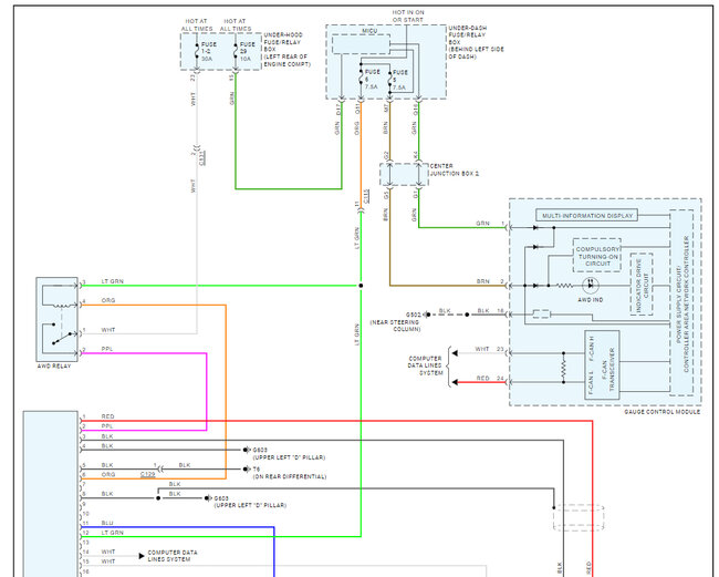

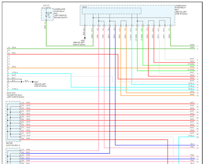

Hi Pros, can I have the AWD diagram can bus signals, light stays on dash, and these are the fault codes I get U100-00 / C1841-13. Please take a look at the images I sent.
Sep 30, 2024 at 6:42 AM
  • 55,381 POSTS

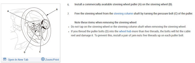

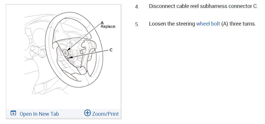

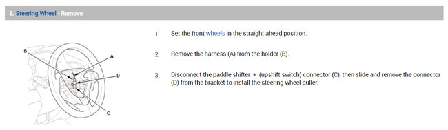

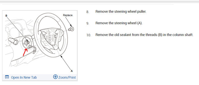

These codes are on because the steering wheel angle sensor needs to be replaced.
U1000-00 - CAN Communication Malfunction:
C1841-13 - VSA (Vehicle Stability Assist) Sensor Malfunction:

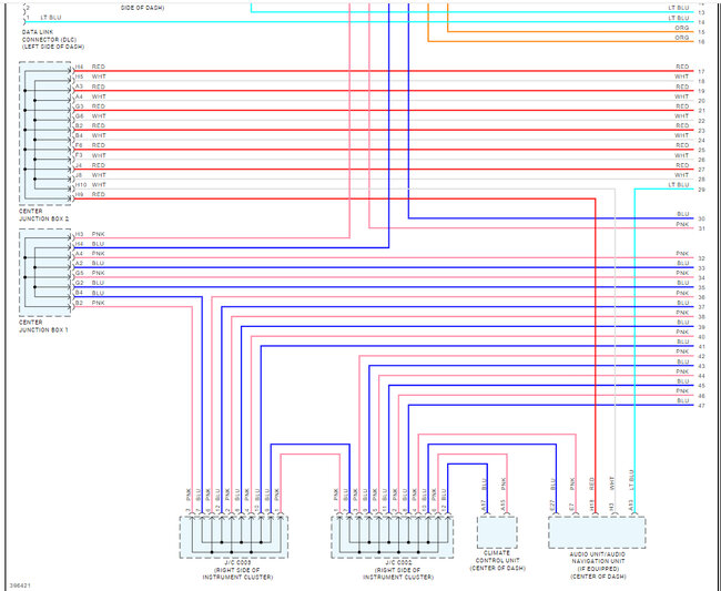

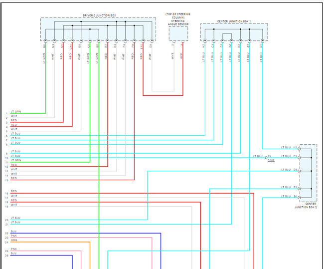

Here is how the job is done to help fix the problem, also clear the codes once the repair is completed. I have included the CAN bus wiring diagrams as you requested. Check out the images (below). Please upload pictures or videos in your response of any problems so we can see what to help you with.

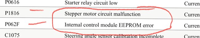

I reprogrammed the steering angle sensor, the fault does not show up again, but I do still have the AWD light coming on and off in different intervals.
Let me provide new codes I have.

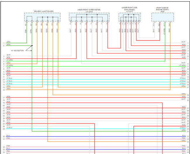

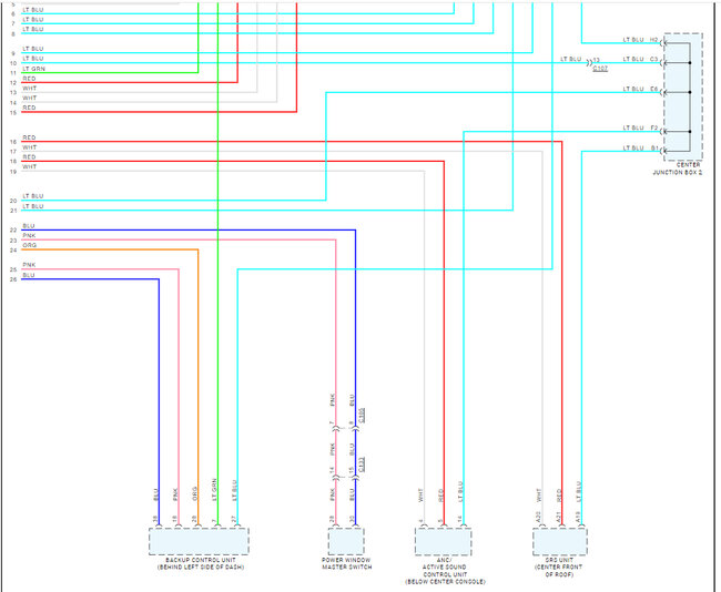

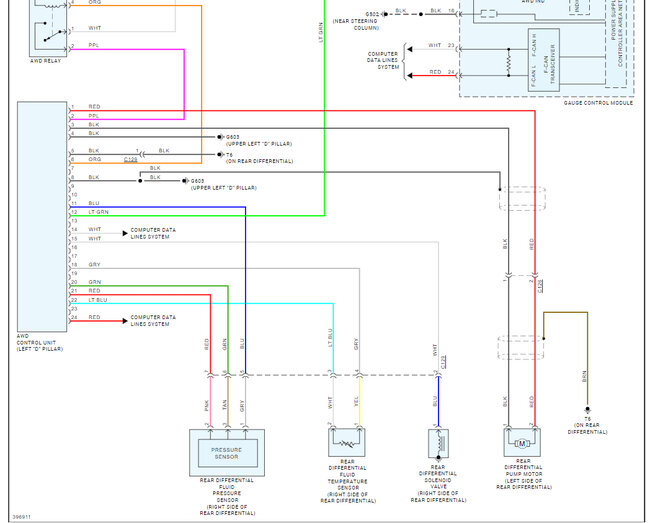

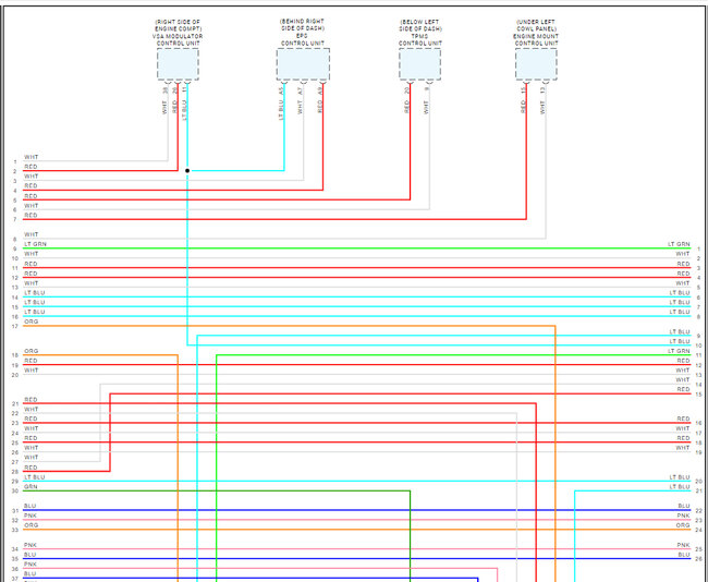

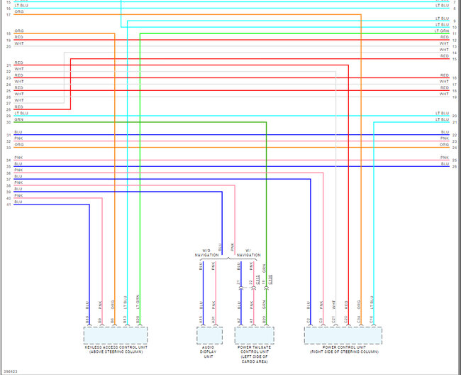

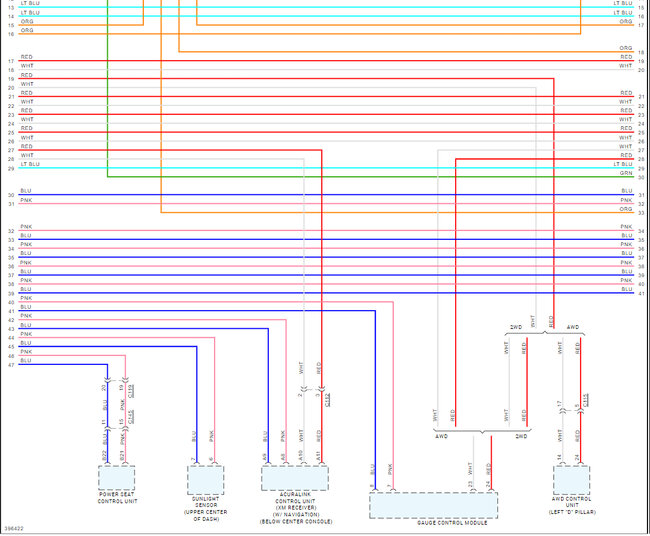

Hi Ken, please help get me diagram for the can high and can low for this fault, so I can follow the can bus network to see where the communication ends.
Oct 10, 2024 at 2:21 AM
  • 55,381 POSTS
Sure, here is the high and low speed CAn BUS wiring diagrams with a guide to help you with the testing.
