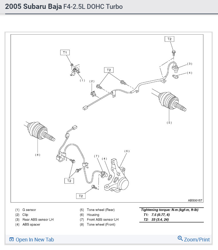

The AWD light comes on if I go over 50 mph. Just replaced motor and right front strut (from Subaru, not aftermarket strut). The manual says its from different tire pressure, but that has been checked, as well as new tires. I am truly at wits end. I miss my Trar! Any ideas where to go from here?

It sounds like you have a wheels speed sensor that is going out. Nut to be sure please follow this video to gather ABS codes.
https://youtu.be/rTtAnsOlZU4
Here is how to replace the sensor below. Please run down this guide and report back.

Thank you. Question, the picture is kind of hard to read. Is that for each wheel, or is it one for the front and one for the back? And how do you know which one is bad/malfunctioning?

That is for each wheel should be similar for front and rear. Once you do the scan it will show the code telling you which wheel is effected.
