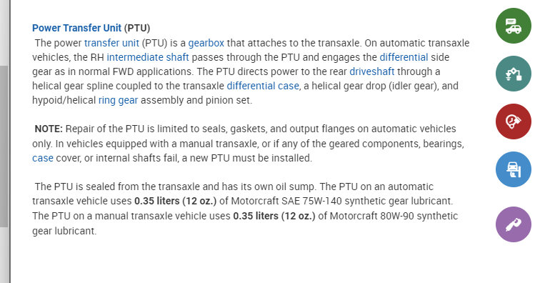

Your vehicle has what is called a torque coupling system. Basically, this means the vehicle is in 2WD until it is determined that 4WD is needed. At which point, the clutch is applied, and the driveshaft and rear diff are locked and you have 4WD.
If when this is engaged you hear noises, then most likely the clutch has failed.
However, first we need to find out if you replaced one, two, or three tires at a time and not all 4. On this vehicle you must replace all 4 tires at the same time otherwise you will cause damage to this system.
At this point we could have an issue with the rear differential and/or transfer case. So, we need to put the vehicle on jack stands and lock the 4WD system and see if you can pinpoint where the noise is coming from.

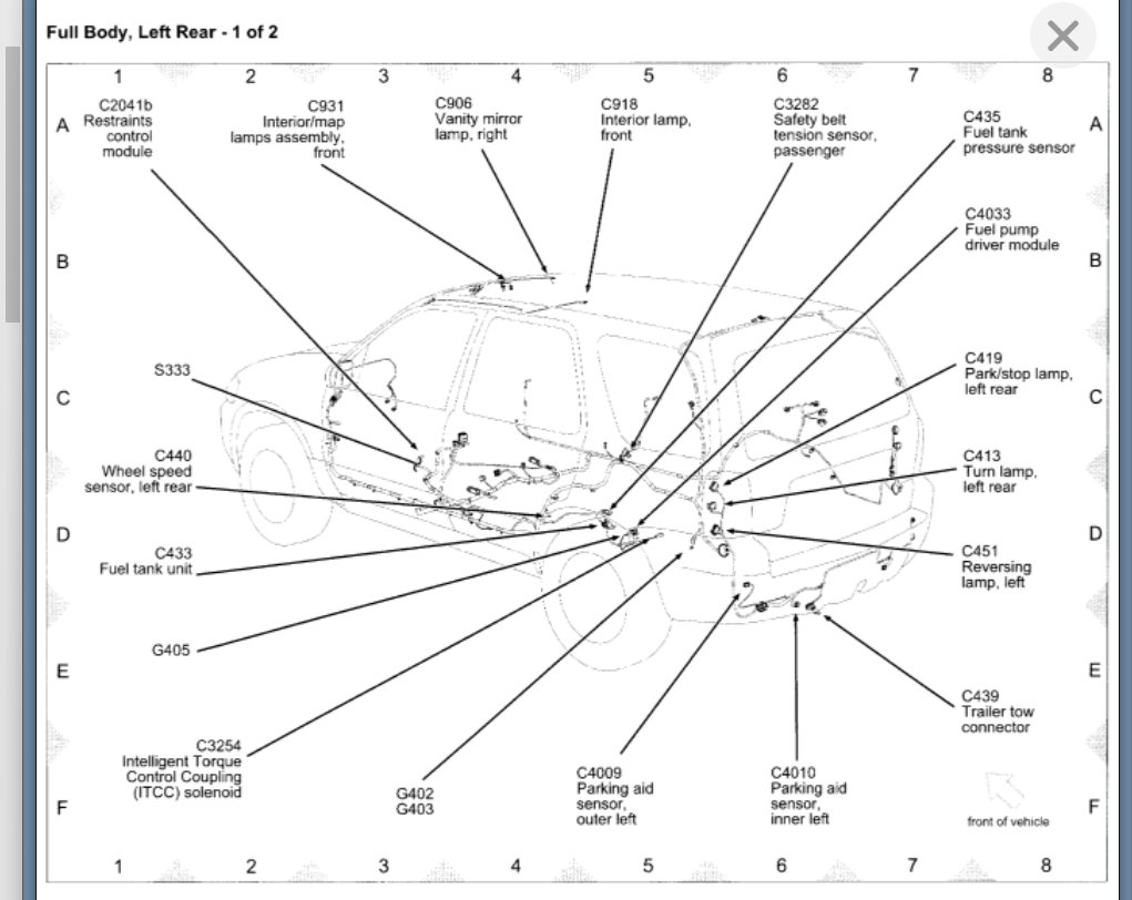

Let's start with this and then that will determine what direction to go. If you are not sure if this is a PTU/transfer case or rear end, then you can unplug the rear coupling unit and see if it still makes the noise. If it does, then the rear diff is not the issue.
