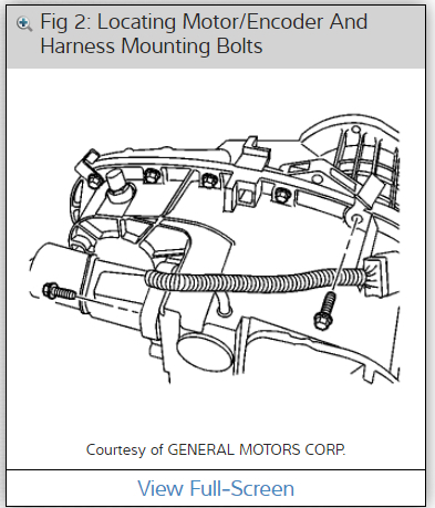

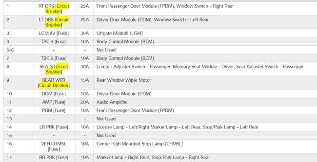

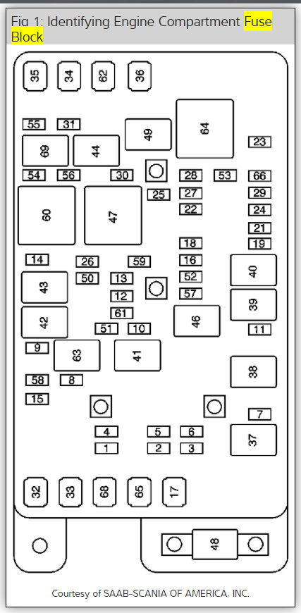

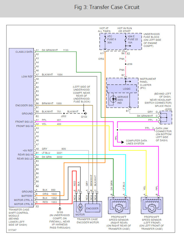

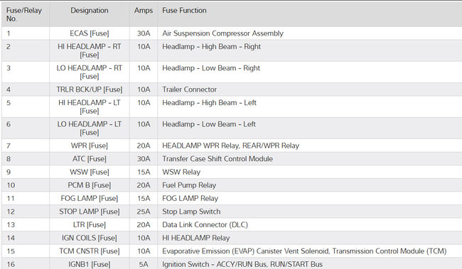

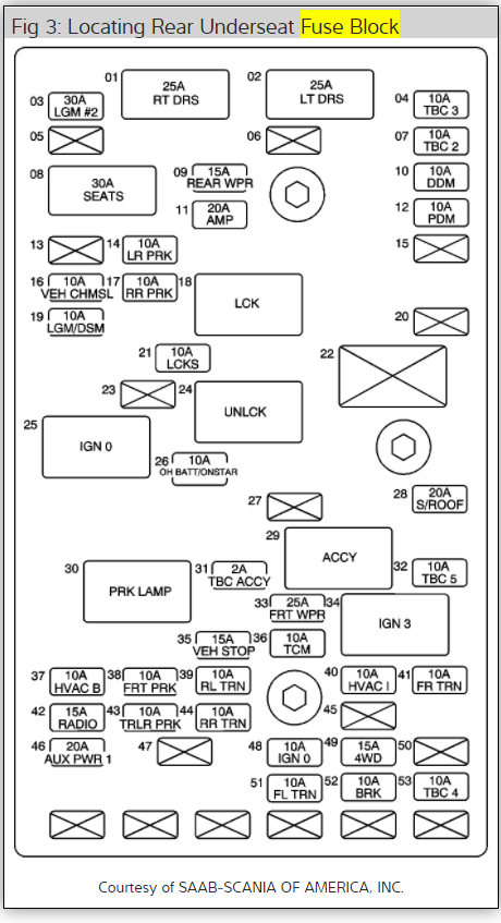

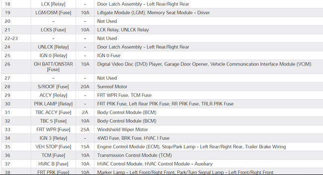

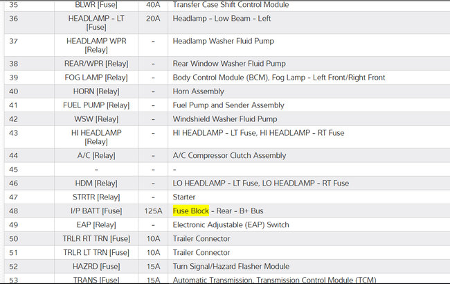

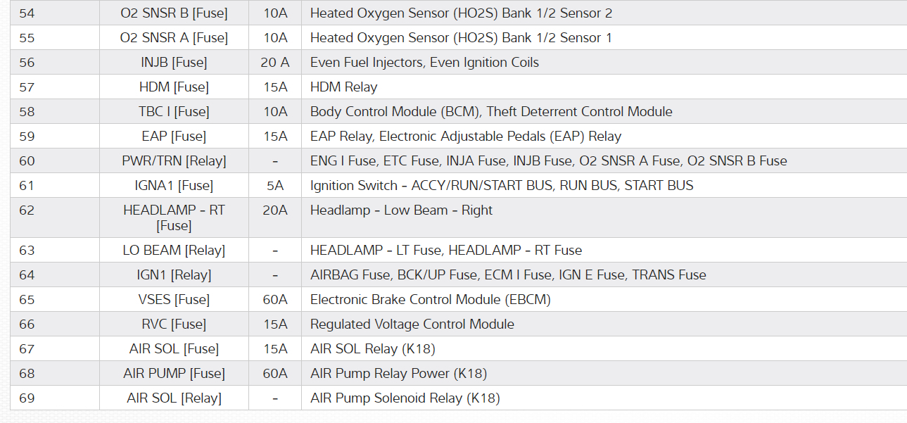

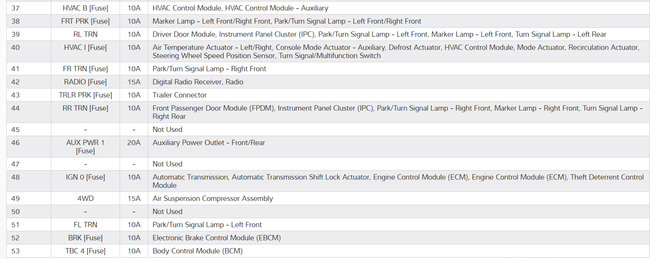

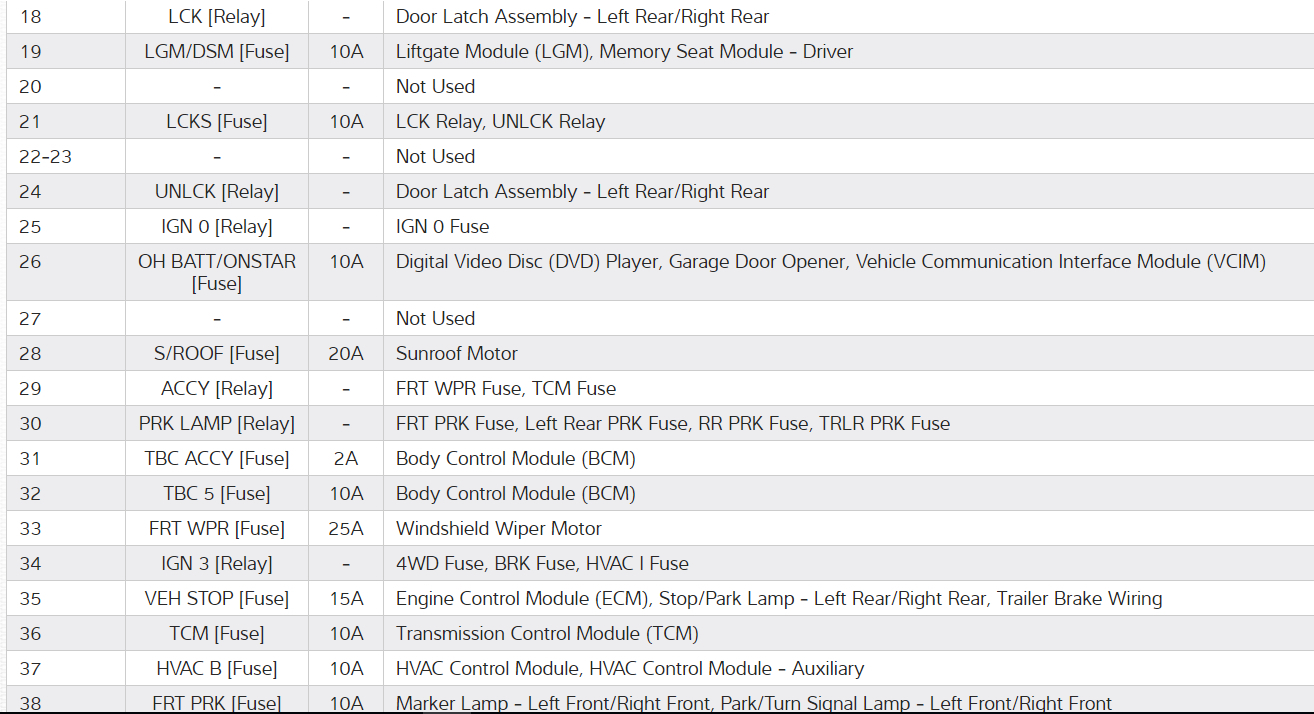

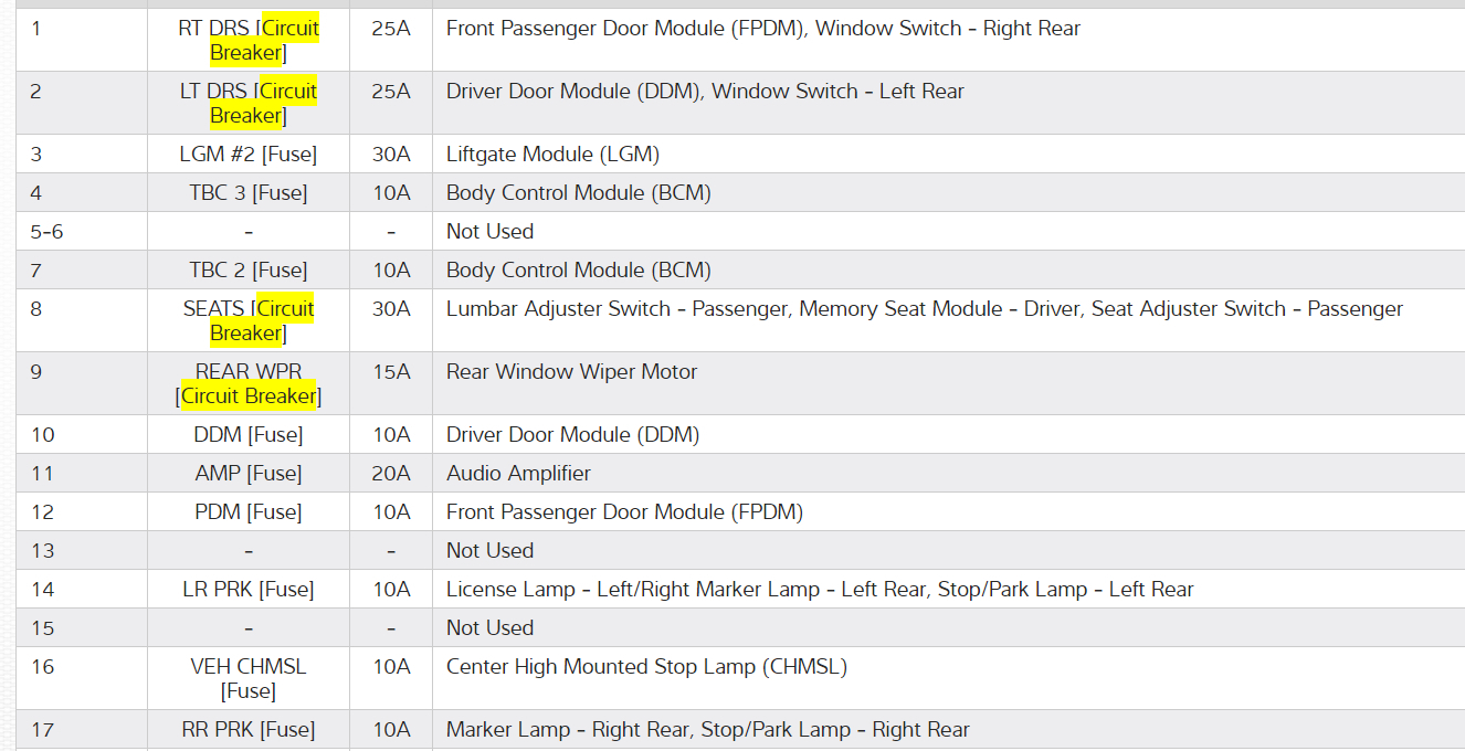

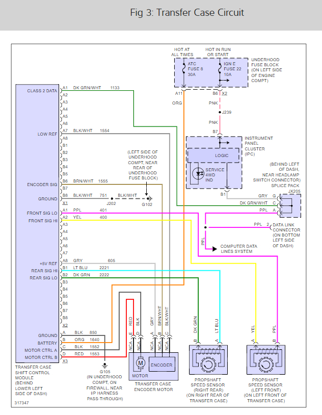

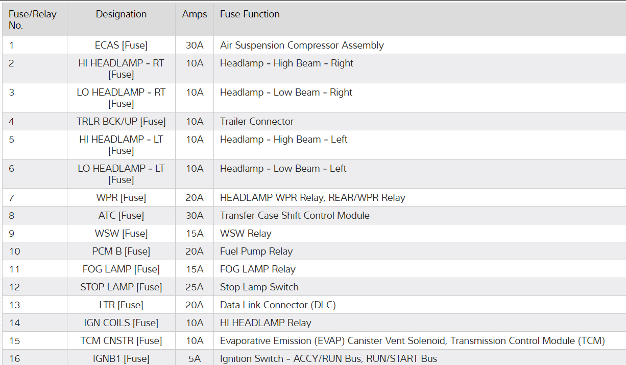

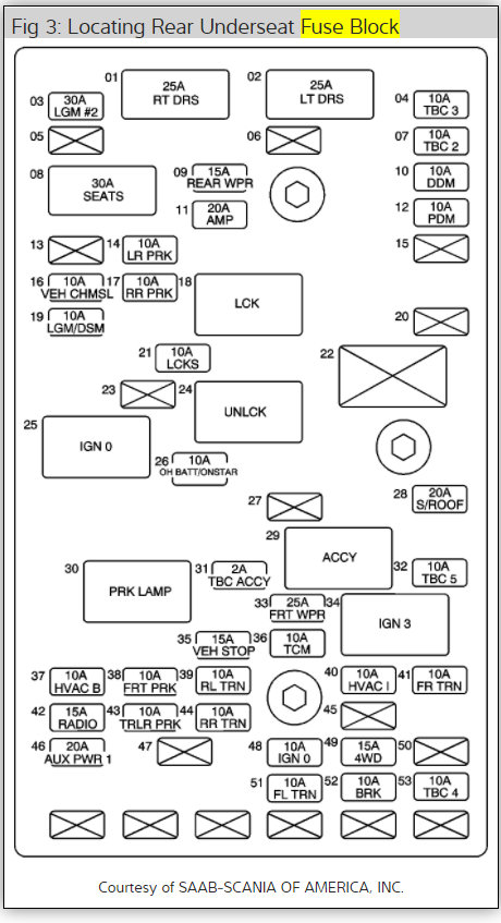

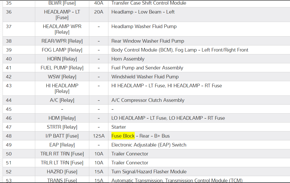

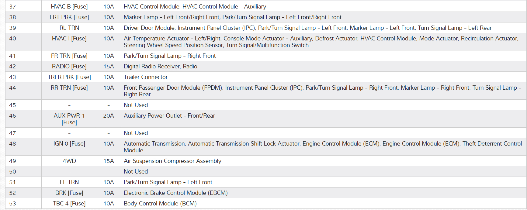

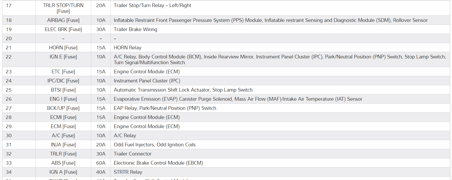

Okay, sorry lets try a different approach. Here is the wiring diagram for the all wheel drive unit so we can see how it works. There are three fuses I would check first # 8, 49 and 22 here is a guide to help us check the fuses.
Here are the fuse panel locations and identification.

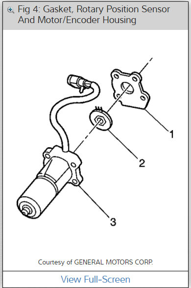

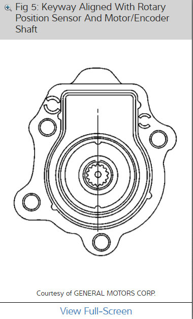

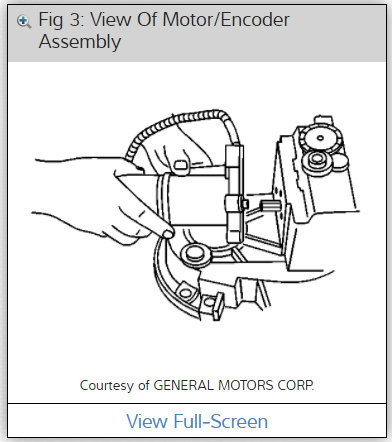

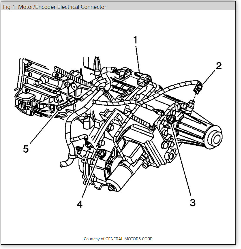

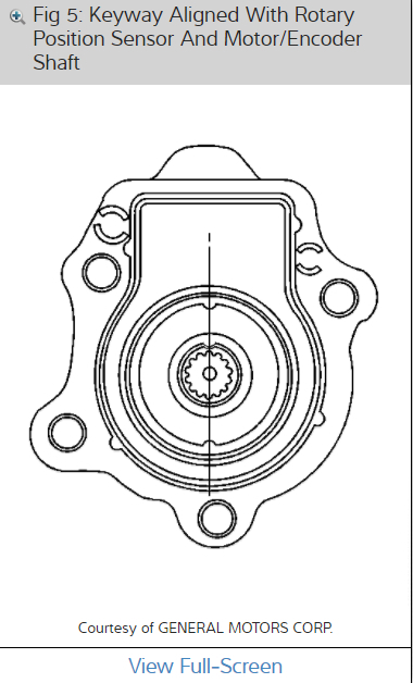

If the fuses check out I would see if the encoder motor is getting power and if so I would replace the encoder.
