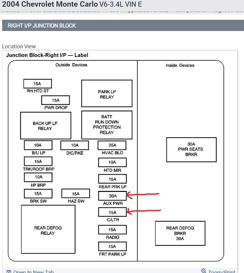

The auxiliary outlet in front not working?
2004 CHEVROLET MONTE CARLO
135,500 MILES
FRANKIMAN
MEMBER
1 POST
Nov 3, 2023 at 3:21 AM
Experienced Mechanic
55,628 POSTS
Please check the fuse C/LTR and AUX fuses in the fuse panel on the right side of the dash (access panel). This guide can help and check the images below:
Check out the images (below). Please let us know how it goes.
