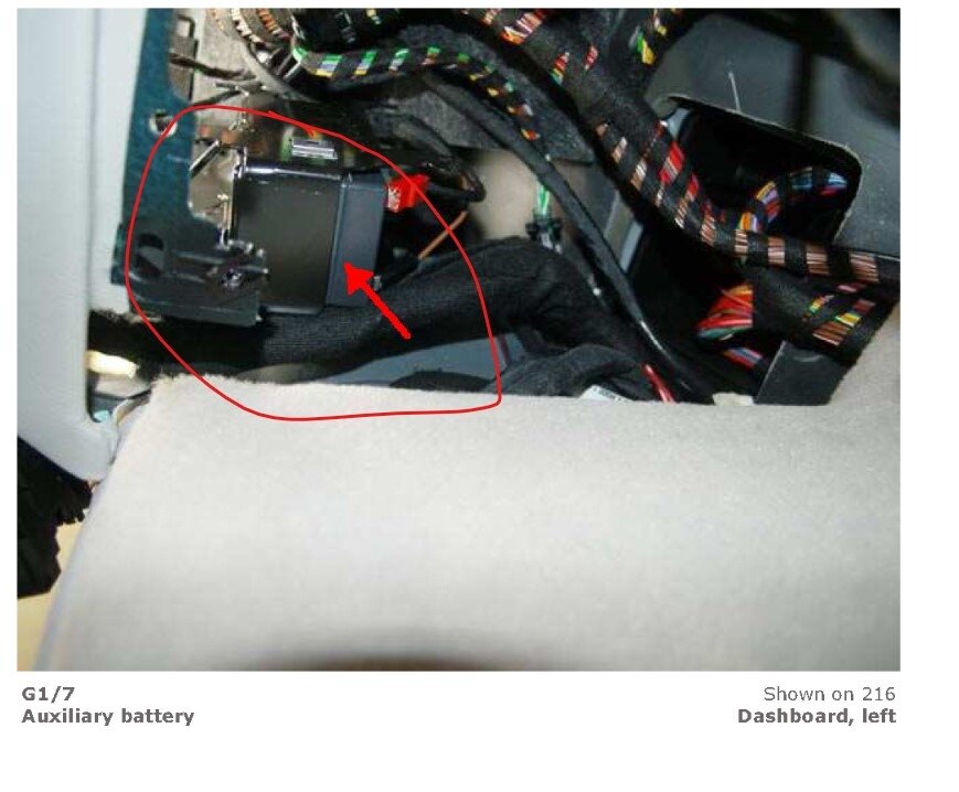

Got a message on dash. Where is it located?
Oct 3, 2022 at 2:16 AM
STEVE W.
  • 15,410 POSTS

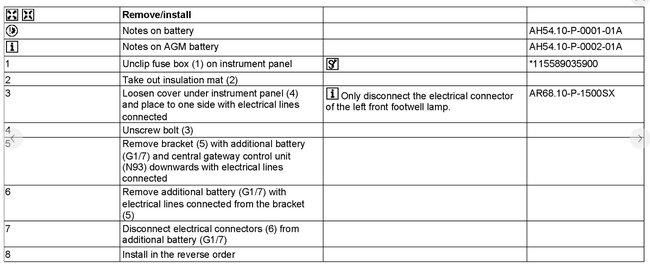

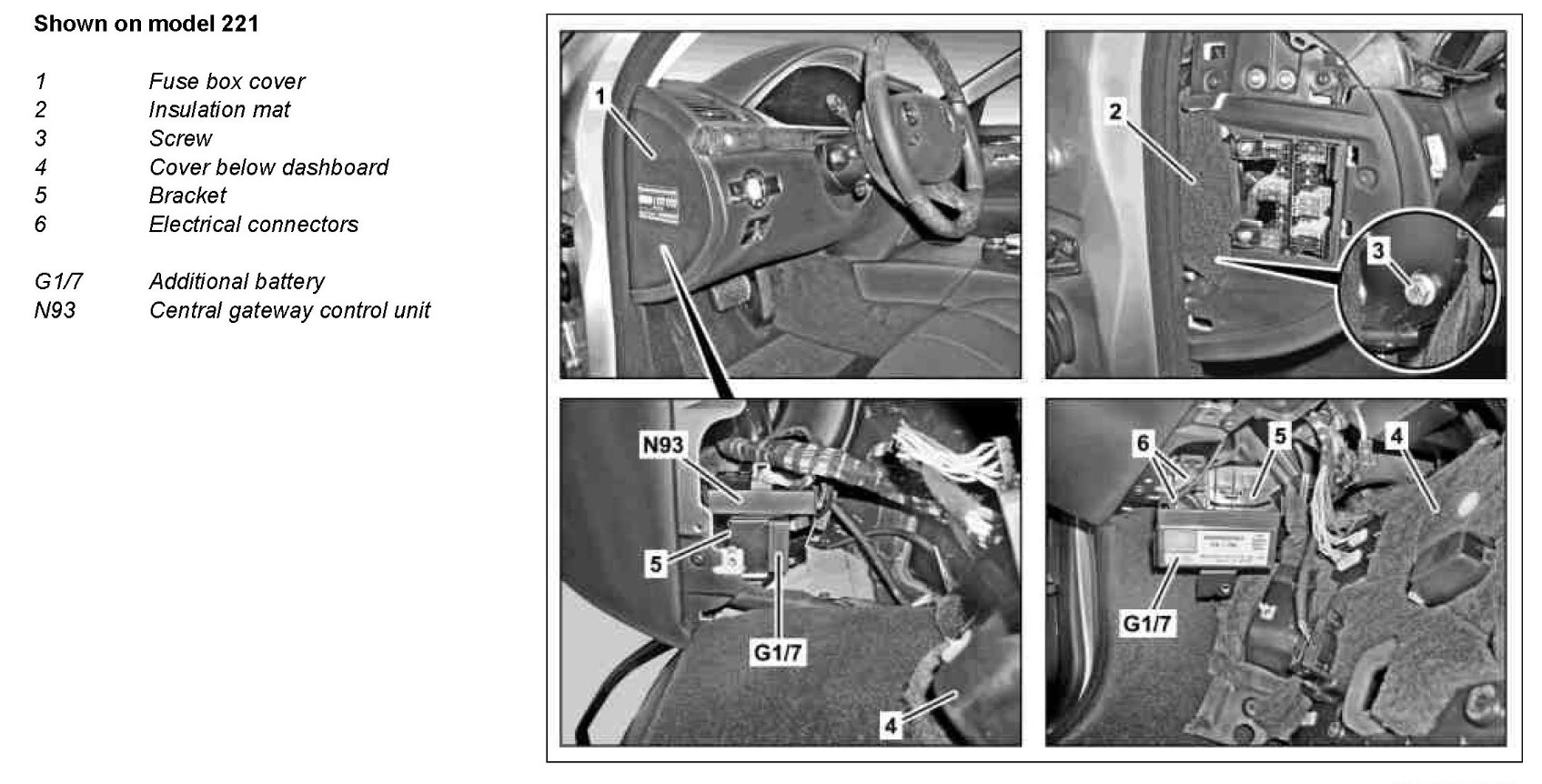

It is hidden up behind the dash on the A pillar to the left of the steering column. To access it you remove the trim panel on the end of the dash and under the dash in the drivers footwell. Then you can get to the battery retaining screw that is behind the dash end cover and lower it out the bottom. Reverse the procedure to replace it.
