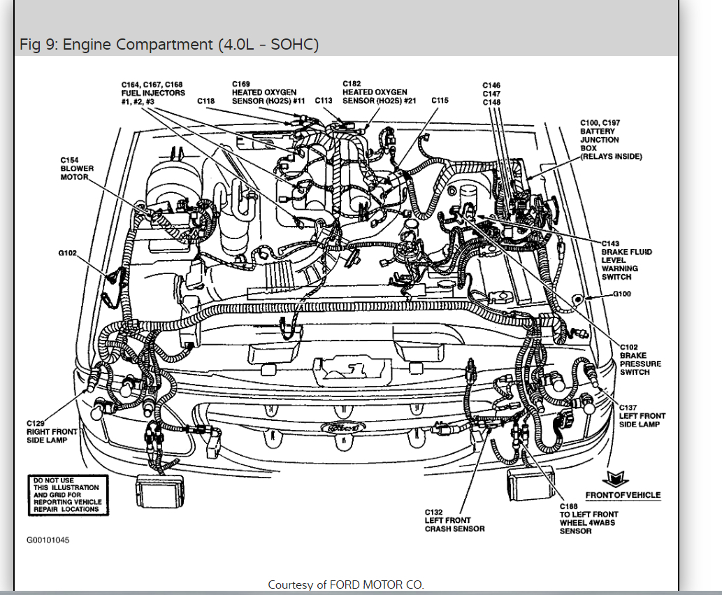

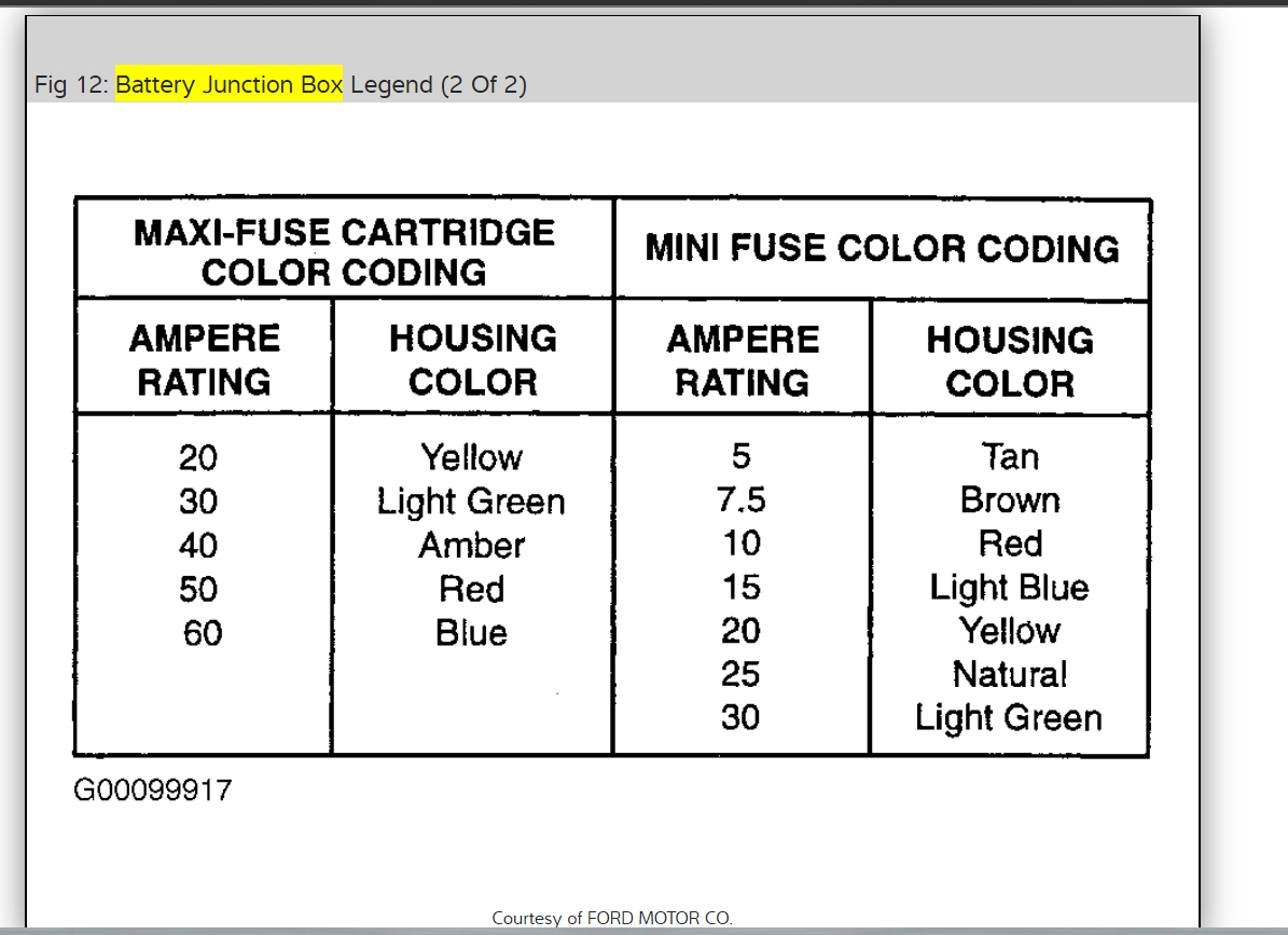

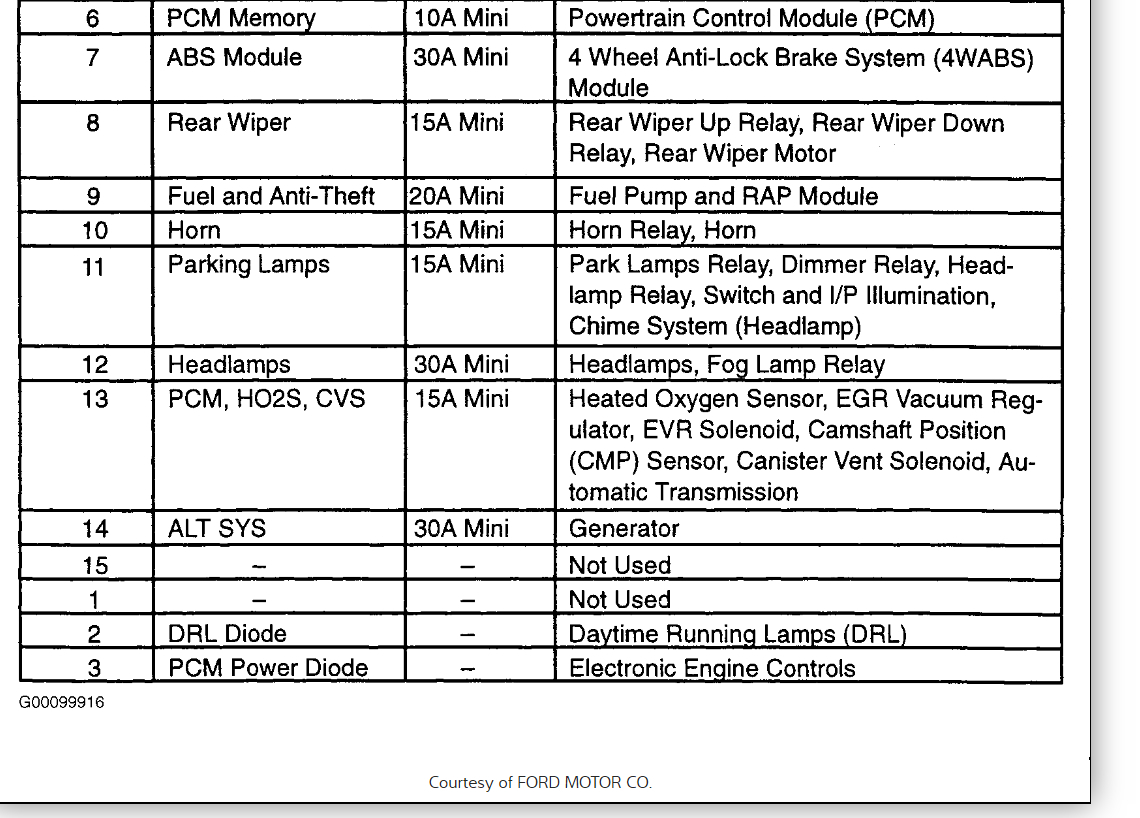

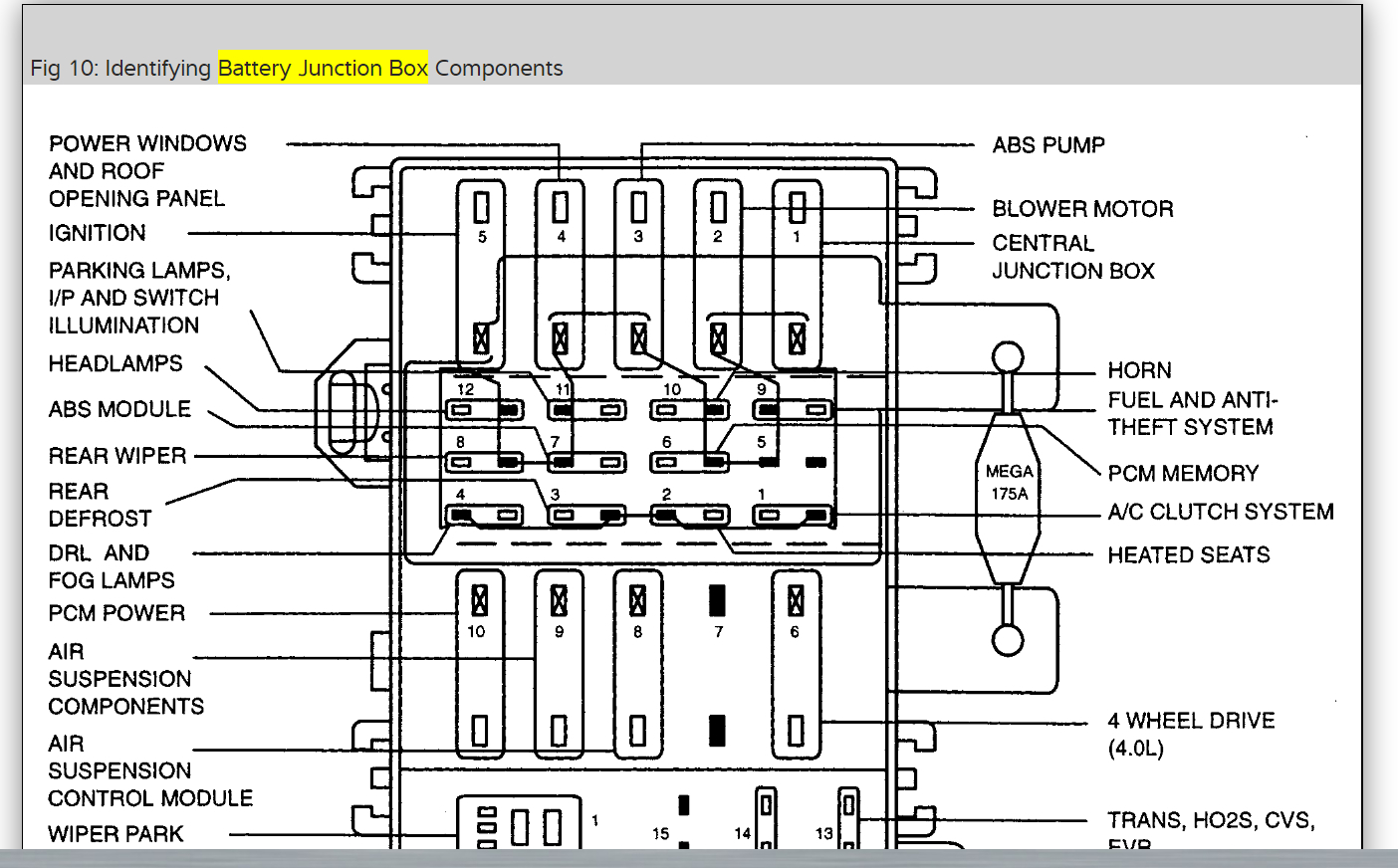

The under hood relay box for the fan relay located under the upper radiator hose passenger side:
How do you open the cover of this box?
How do the clips work?

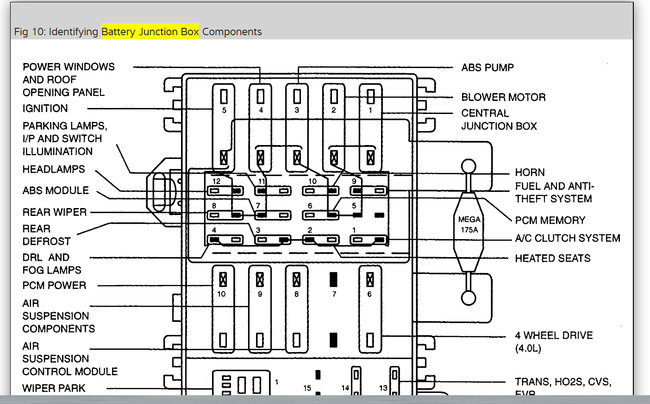

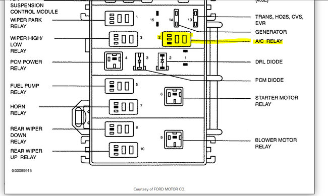

I want to check the heater fan relay.
Tuesday, July 2nd, 2019 AT 10:07 AM
SCGRANTURISMO
  • 4,897 POSTS

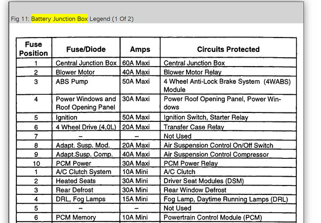

I have included the Battery Junction Box diagram and callout for you in the diagrams down below and I also highlighted the A/C fuse for you as well. The clips on the side should just pull to the side and then up. Please get back to us with what you are able to find out.
