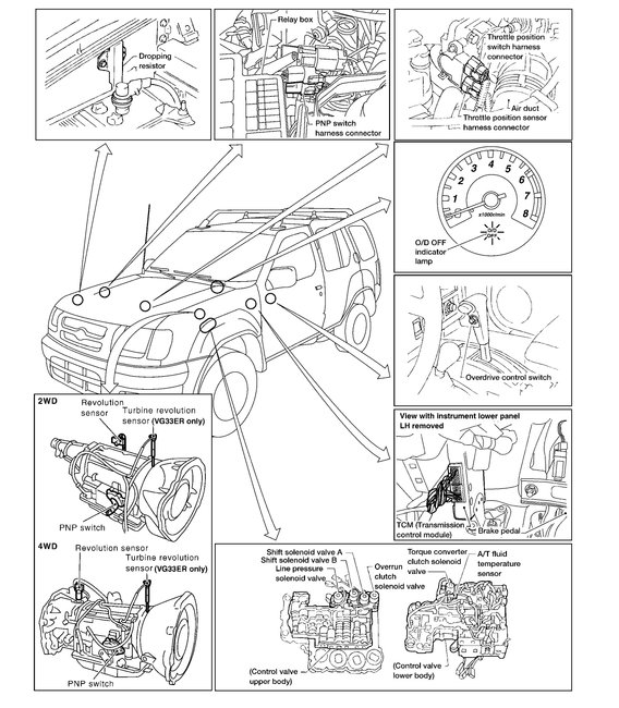

Transmission will not shift out of second gear to third gear.

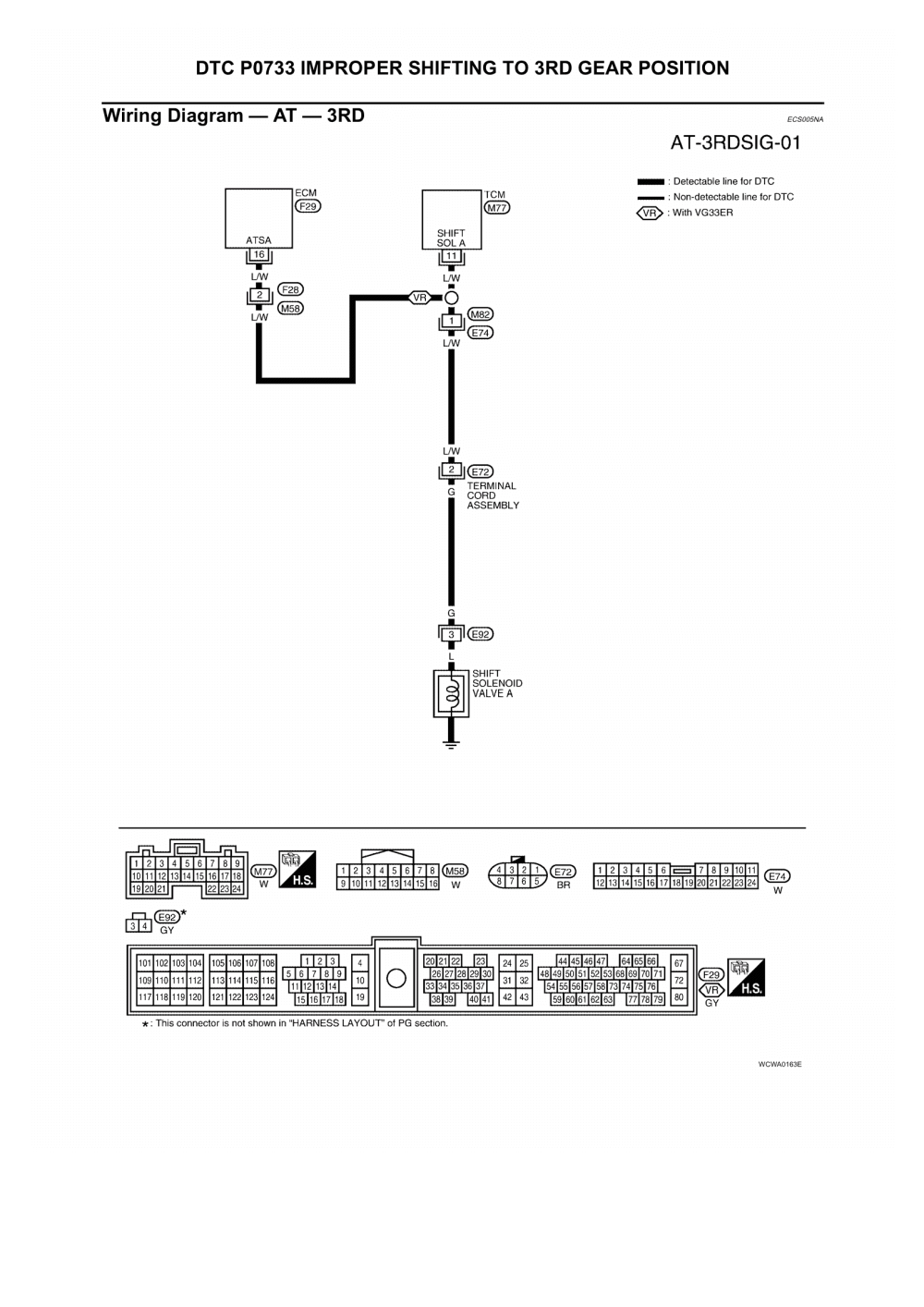

To be honest, it sounds like it could be a shift solenoid that could be bad. I have attached a picture to show where they are located. To access them, you will need to remove the transmission pan and access the transmission valve body. I have also attached a wiring schematic of shift solenoid A for your review. If in fact you get the aforementioned trouble code, there is a good chance the solenoid is the problem.
I hope this helps. Let me know what you find.
