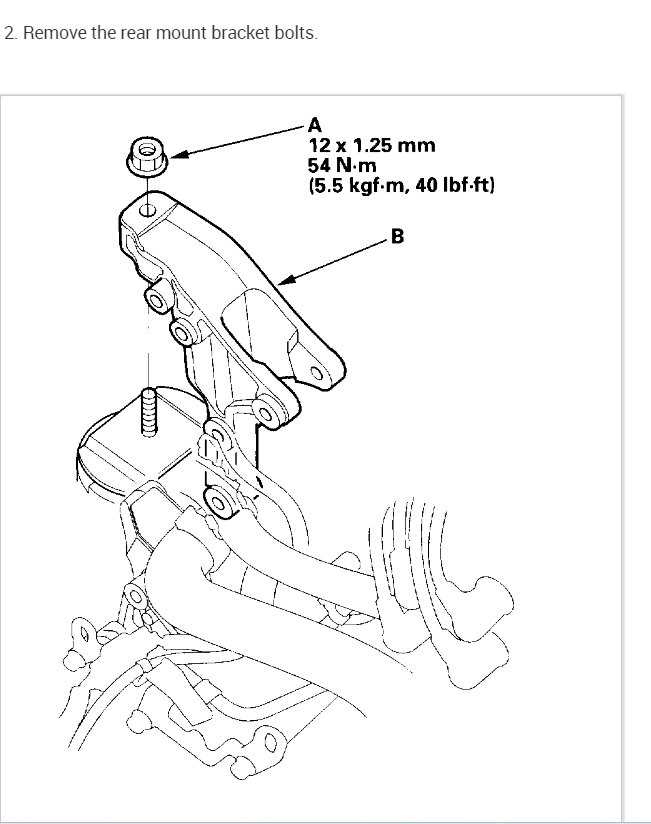

Hello again,
Ugh I'm having problems switching the oil pressure switch. The new one is a 22in so I have a deep socket thin wall 22in. But it's not taking it from underneath the car.
Do you happen to know which way I should come from because it just seems like too tight of a fit.
The switch is next to, on top of the oil filter.
Any advice would be wonderful. I just want to get my CEL off. Lol

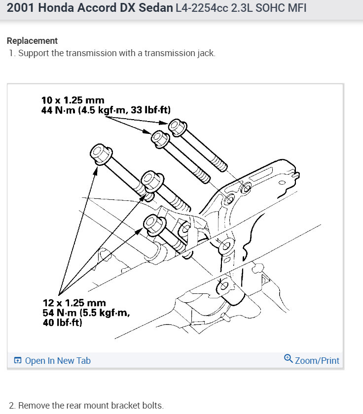

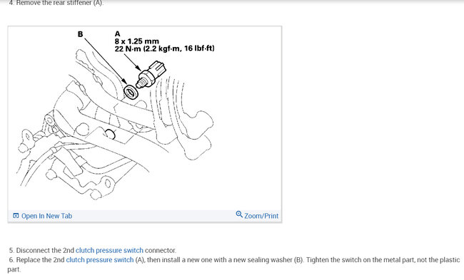

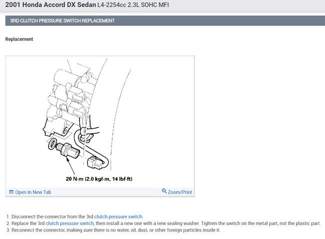

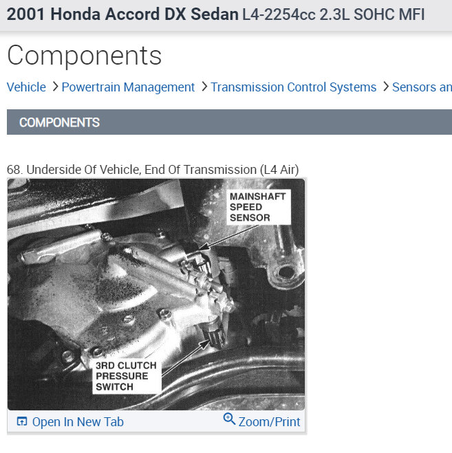

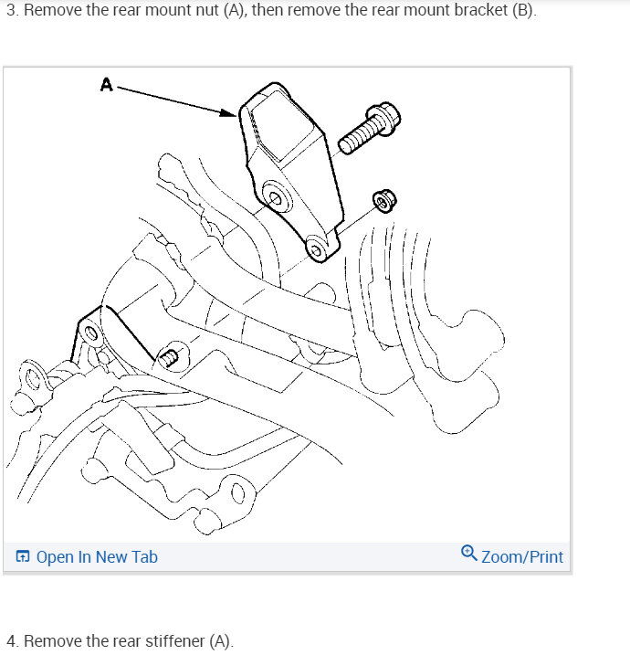

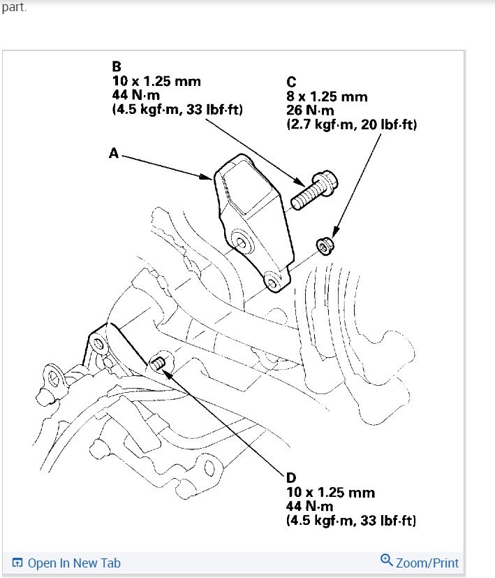

It looks like there are two oil control pressure switches on for 2nd and the other for 3rd. Here are the instructions on how to replace both which it looks like some brackets will need to be removed. Check out the images (below). Please let us know how it goes.

I got the 2nd clutch sensor out and replaced it. Thanks for your help. You guys' rock!
