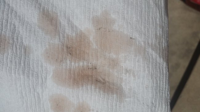

I have about 208,000 miles on my vehicle listed above, and I have flushed the automatic transmission exactly once. I estimate about 10 years and 80,000 miles ago. I've attached a picture of what it looks like now. There's a tiny bit of black carbon from the bottom of the dipstick, otherwise it's a little dark but still quite reddish, not totally burned by any means. My car has started shifting a bit hard or slipping a bit when going from 3rd to 4th gear (I think) around 40 mph or so. I noticed the dipstick reads at just above (or at) the lower hot line when warmed up. What would you recommend I do at this time? Topping it up to halfway between the bottom and top hot lines and seeing if there's any change in symptoms seems logical. What about using a product like Stop Slip in lieu of normal transmission fluid?
Technically I'm definitely due for a transmission flush. But I've heard that can actually make the problem worse on high mileage vehicles. Although it sounds like that's mostly if the fluid is burnt and full of metal shavings. Please advise on whether it's best to flush, drain/fill (which only replaces about half the fluid I've heard), or just top it up and leave it alone for now. Personally I don't like the idea of driving it as is until the transmission stops working.

Good afternoon,
I would not flush it at all. I would just change the fluid and filter. That is required to do to keep it working correctly
The flushing agents are too aggressive and can damage the clutches.

Okay, you never tell anyone not to change there fluid. They are telling you that just wait until it fails. That is like saying you have chest pains but do not worry about it until you pass out.
You can use the fluid from the parts store. Just make sure it has the designations for the fluids.

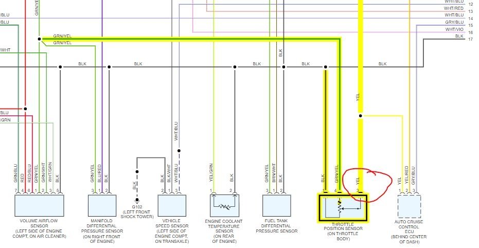

Did you verify the signal voltage?
May 30, 2020 at 7:05 AM
KIWASABI1
  • 202 POSTS
We calibrated the new one to .58 (the acceptable range is .535-.735). The guy who sold it to me said he tested it first with a multi-meter. Mostly I've just tested it by driving it, which it has been perfect. The old one was getting all kinds of dead zones when I tested that one which corresponded to the bucking acceleration.
Anyway, I've got an ELM OBD2 Bluetooth scanner. For whatever reason I can't get the TPS voltage off of it, but I can get the throttle open % and see the graph. So I can verify no dead zones that way. So I'll double check that as well.
May 30, 2020 at 7:09 AM
You need to back probe the signal wire and check the voltage sweep.
I am looking for actual voltages and not concerned about the TPS itself to see if it a wiring issue.
May 30, 2020 at 7:22 AM
I attached the diagram again for the TPS. Monitor the yellow wire with the key on. Then go from 0 to 5 volts.
May 30, 2020 at 7:28 AM

Alright I'll get that done. I will say that the TPS voltage itself is not holding completely steady when the car is running, but it is when it's stopped. So when it's running and idling it bounces between .58 and .60. Now this is an improvement compared to the last one I had, which was bouncing between .60 and .725 or so. I was going to attach an extra ground wire to the TPS to see if that fixed this. I was instructed to just leave it alone though since the car was functioning properly. But now I'm reconsidering it.
Anyway I know you're talking about testing the wiring connector, not the TPS itself. So I'll have my mechanic check that for me and re-evaluate adding an extra ground wire.

Oh I see, so you're talking about the TPS voltage. Okay, yeah my mechanic's scan tool is capable of displaying live TPS voltage, but mine isn't. So I'll check that out. Basically we're just checking for dead zones right?
May 30, 2020 at 7:29 AM
Yes, you need a voltmeter to do it manually.
You are looking for a clean sweep of the voltage from idle to wide open throttle with the key on, engine off.
