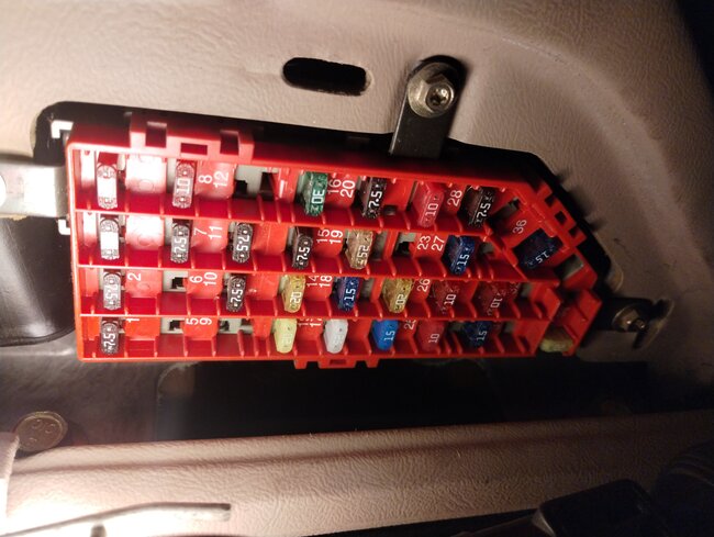

I recently purchased the truck listed above flex fuel. I purchased it with the understanding the transmission (4r44e) was bad and there was no reverse gear. I installed another 4r44e, filled the fluids to spec, and when I tried to operate the transmission there was no response (idle/rpm reduction in R, D, 2, and L). Upon troubleshooting I happened to notice there were numerous fuses blown and on the fuses which tested "good" the prongs were scorched and looked like there was an extreme power surge. One of the blown fuses was to provide power to the OBD II port. (I connected my code reader and there are no codes to read.) While the engine was idling, I noticed the battery voltage gauge indicator needle was not moving at all. I also notice I have had to jump start the vehicle the last few times I started it, whereas I had not when I first purchased the vehicle.
I'm assuming my alternator is bad, but what would cause approximately 5 fuses to blow and scorch the remaining? Is there a correlation between the transmission not engaging any gear (all the forward gears operated well, just not reverse) and the electrical issues?

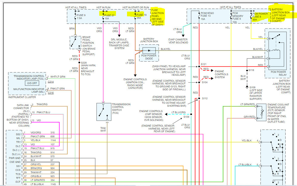

Certainly, the fuses could be related. Which fuses were they and where are they located? Also, when you shift, is the shift cable moving the shift lever on the transmission?
I attached the wiring schematic for the transmission below. I highlighted the fuses I feel may be a cause. Let me know if they are blown and which others are. Also, let me know if the gear indicator is working properly.
See pic below.

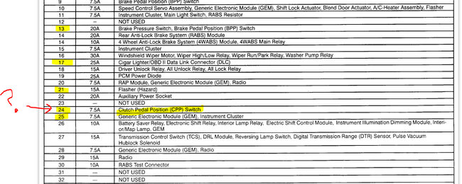

Joe, thanks for your response. When I replaced the blown and scorched fuses, I didn't write down which ones were blown. I know I replaced 4 of them vertically on the far-left column as you look at the fuse panel. Numbers 13, 17, 21, 25, and 24 I changed (they look different than the others). I would have changed more but I ran out of fuses. The ones you highlighted in the attachments I will double check and let you know.

The interesting thing here is you mentioned the failed fuses and added the others were scorched. That shouldn't happen.

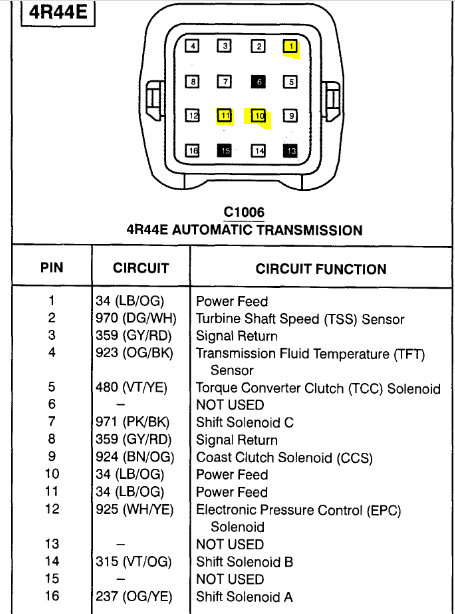

I looked up the fuses you mentioned and none of them are related directly to the transmission. See pic below. When you installed the new fuses, did you check if there was power to them, specifically fuse 25 (GEM)? If not, confirm it has power. Also, the other fuses are of interest. Fuse 24 should be empty on this vehicle. It is for the clutch pedal position switch.
Do this. Disconnect the connector at the transmission and check pins 1, 10, and 11 for power with the key on. See pic 2.

No power to either of the three pins. I had the ignition key turned to on for power and I grounded the clamp of the probe to the frame. Each of the 3 female plugs were lights out.

If you aren't getting power, make sure the GEM fuse you replaced has power to and from it. If it does, we have an open between the GEM and transmission. Likely, we have a short that is what caused the fuse to fail.
