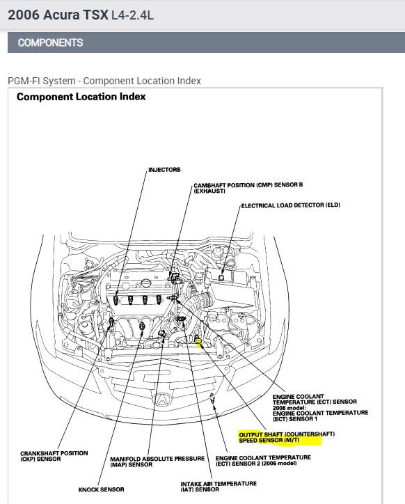

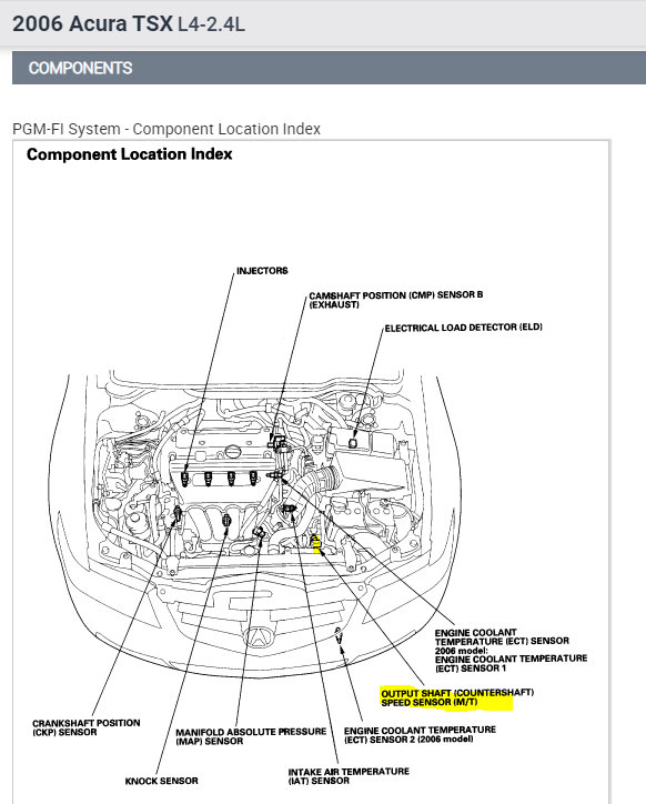

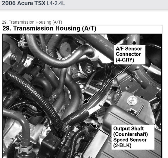

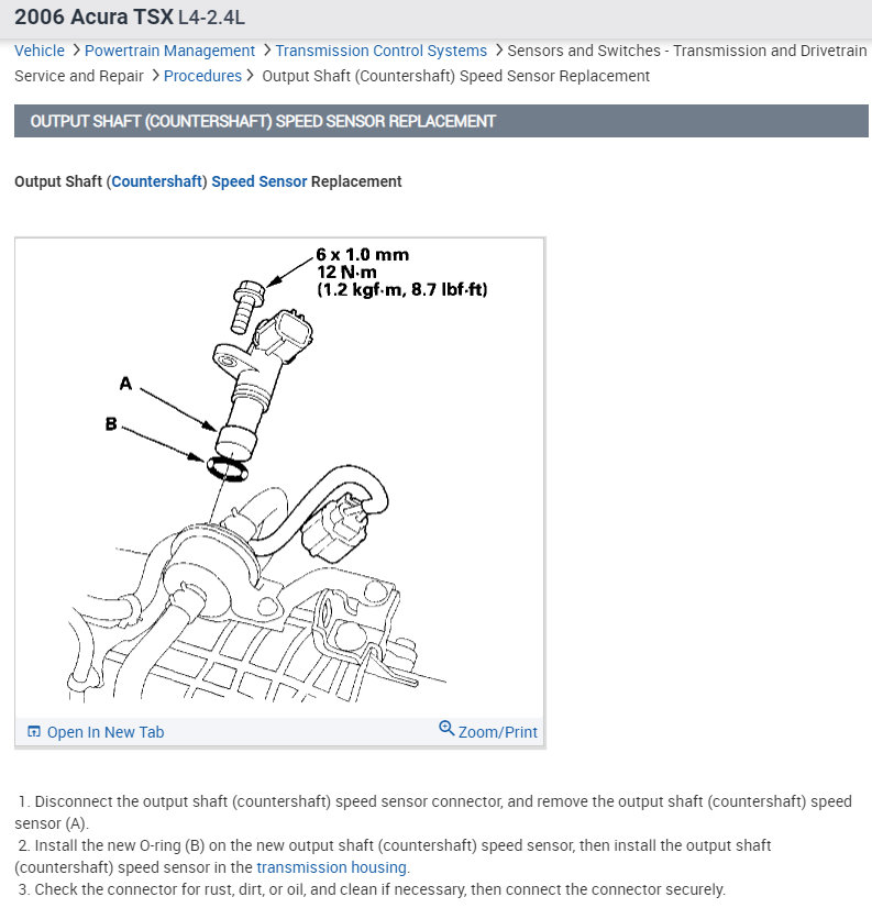

I having problems finding the output shaft speed sensor. Can anybody help me find the location of that sensor? Thanks
Jul 4, 2022 at 11:55 PM
SQM
Experienced Mechanic
6,383 POSTS
The output shaft speed sensor is located on the top of the transmission on the driver side.
I have attached diagrams below for your reference.
let me know of any questions.
