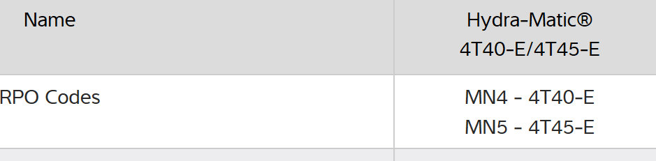

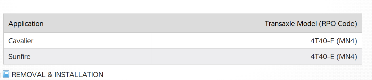

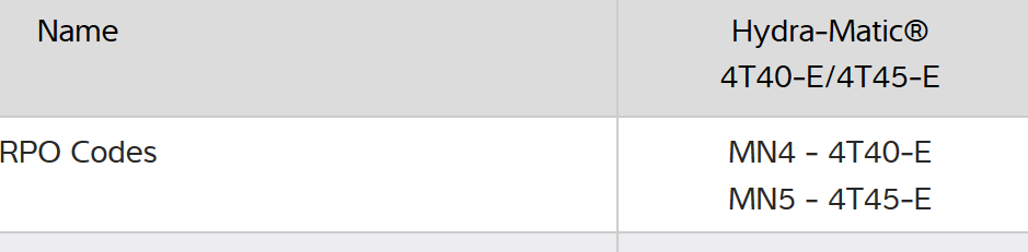

Are 2004 Chevrolet Cavalier four cylinder automatic transmissions and 2002 four cylinder automatic transmission interchangeable?
Sunday, July 9th, 2017 AT 5:28 PM
HMAC300
  • 48,601 POSTS
As long as they have these same tags on both or identification. Prior to replacing however check for the same electrical hookup as connectors may be different then you cannot do it. See pictures.
